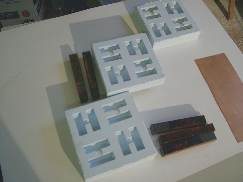

(shameless plug ..)
Depending on the kit (I don't have them for all pen types yet) you could
re-cast a broken, blown-out or overturned blank with one of the molds
I'm working on. They're kit specific. You mount the tubes in the mold and
pour more resin. That would allow you to recover from broken blanks or
add more resin to an overturned blank. It won't, however, fix a cut skin..:tongue:
