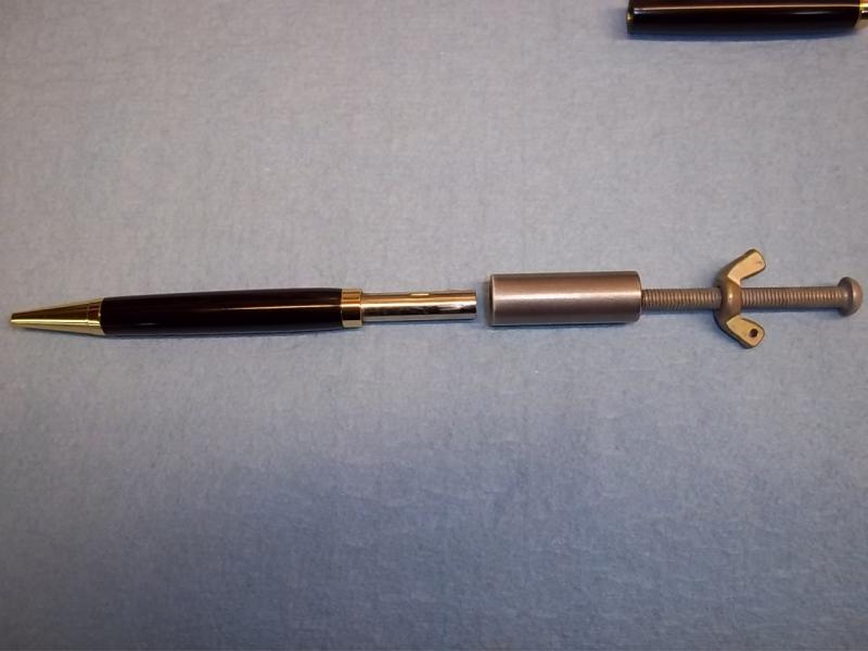

Thanks so much for your info. I was trying to remove the transmission from a slimline pen without damaging it. Here's what I came up with and it seemed to work fairly well with the 10-32 screw but I'm sure would work better with the correct threads. I've only done this twice, so I'm not positive it'll work every time.
As you can see in the photo, the sleeve is about 1.25 long with a 9/32 hole drilled through. It's slipped over the screw and wingnut, then screwed into the transmission. By holding onto the pen body and tightening the wingnut, the transmission will slide up into the sleeve and out of the pen body.
I guess this will work on other pens but I've only tried it on slimlines. Hope this helps someone else down the road.

That happened on the third one I tried also. Maybe I need to go back to the drawing board on this one. It worked the first time I did it, but....."one trick don't make a circus".
So sorry if I misled anyone on this tip. Thought I was being helpful.
