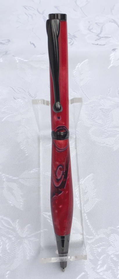

Yes, I can!
Thanks to each of you who offered encouragement and suggestions, I have just finished my first acrylic slimline. It is a Craft Supply Apprentice Fancy Slimline kit.
I painted the inside of the blank with white spray paint (I thought it would highlight the beauty of the acrylic, and it did). I waited 4 or 5 days to let the paint cure before putting the tubes in. I let the epoxy cure for 24 hours and turned it this morning.
The top of the pen isn't as spectacular as I thought it would be; after turning it down to Slimline dimensions, most of the character was sucked into my dust collector. This was one of those cases where beauty really was only skin deep.:rolleyes:
But, I really like the end result.
Thanks again!
