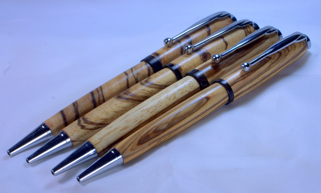

Here is a picture of my favorite slimline design. I rarely make a slimline the standard way anymore.

I have to agree... I really like those no-cb slims... The euro type look is really nice and Don's "black" line effect is awesome! New thing to try! Thanks all!

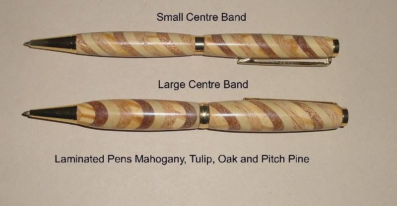

Hello
I use a lot of slimline kits but I also use comfort centre bands to make a his and hers matching pens. I sell about 50/50 of thin and thicker bands.
I much prefer making pens with thicker bands as there is much more wood to play with.
I experimented with all sorts of shapes but I make these basic designs and they sell well.

Thanks Dean and Greg. The longer lower tube gives the euro look along with the larger upper diameter. The black band can be different widths to give different looks as shown. I also like to move the black band up to just below the lower end of the clip.

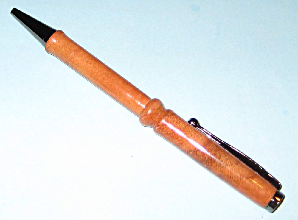

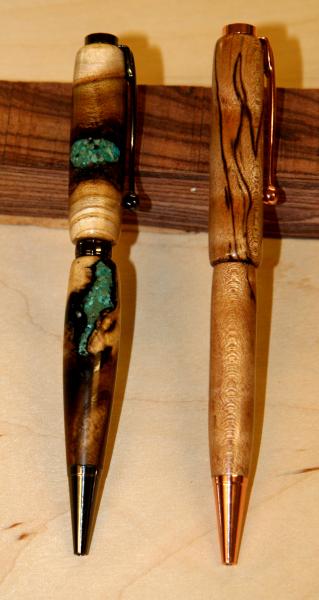

Most of my slims are made very traditionally.
However, two shapes which have received a lot of positive feedback:
In the pen above, the lower barrel slides into the upper barrel with a mortise and tenon type effect so there is no gap between the two.

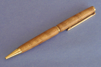

Here's another one which is similar albeit in Black Cherry. My wife has confiscated this for her personal use.

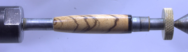

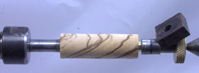

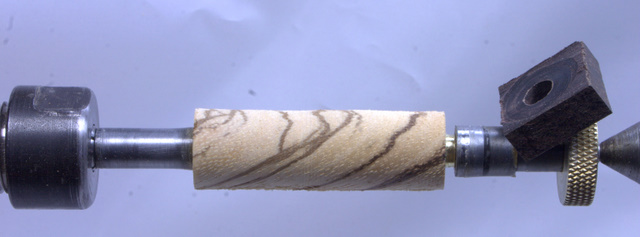

Thanks Peter. They are quite easy to make. Lower barrel longer than normal...I just use the bottom tube length from the euro and cut my own from 10 inch tubes. Measure the unused centerband and make the lower tube longer by that much.
For the top just round the blank and part off the width of the wooden CB you want to use. Cut a slice of the wood you want to use and square one end. I actually drill the blackwood blank and use a tube and pen mill and square the end. Cut off a slice the desired length and glue the squared end in the parted off space. This picture may help.

I really like the look of these. Do you have to drill out the center band segment larger than 7mm?
