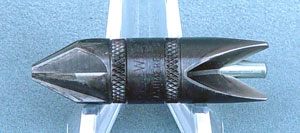

Actually, I have turned Jeff's blanks (a few) and never noticed this. However, I DO use the above reamer, routinely, in all my turning. After you face the ends, you have distorted the brass, using the reamer takes the brass out of the tube and opens the holes.
So, I agree it is (or should be) a normal part of making a pen. As to cracking the resin, I've never had it happen, but I'm not putting a lot of pressure on the reamer, just cleaning the hole. (The gun reamers have fairly sharp fins that work easily and quickly).

Mine is v shaped. Works on every pen I have ever tried, right up to the Emperor.
I bought it either at WalMart or Gander Mountain.
If it is V shaped, then it is not a reamer but a chamfer tool, correct? A reamer would go all the way into the tube and there would be a specific reamer for each size hole..and that's why reamers are sold individually or in sets, but there's never the one you need in a set, like anything else..having ever drill bit in the world but the right one!:biggrin: I'm no machine head, but my understanding of a reamer is that it is kinda like a drill bit, but the flutes go straight instead of spiral. It is used for tuning holes that you would drill with a metal lathe..so if you needed real precision, you could drill a hole a hair smaller than you want and use a reamer to get the hole to that exact size. If you used the exact size bit, the hole could be just a hair too big if the hole was really deep and the bit managed to bend a bit while drilling..thus the reamer is almost like a boring bar. I could be wrong, but that's what I think it is, and because of that, a reamer can't fit every pen size. A reamer would remove any gunk, paint, dirt, whatever from in the hole too, because it's a scraping tool. Go ahead..tell me I'm right or wrong guys.
Thanks for the link Fred..I'll go check out the sizes I need.
mick
Mar 13, 2005
2,608
Decatur AL, USA
Ed, I'm assuming this is what you have. Jeff although it's technically a Chamfering tool we USE it to ream out the ends of tubes...lol
Yea, it's one of them thar thingys in that picherr, up thar!

I also meant the tool that Ed shows a photo of. My thinking is to cut away the material that is in the way since trying to expend the tube back into shape risks cracking the casting.
