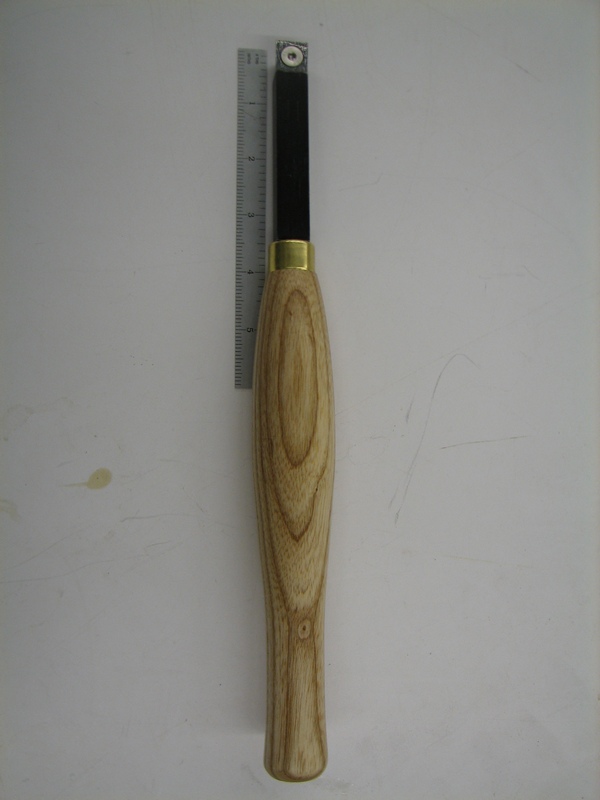

The first photo is the tool itself
The square part of the tool is 14mm or approx. 9/16" and it extends 3 1/2". The piece of wood I received was 9" so the overall length is approx. 12 1/2". You'll need a 1/2" bit to drill the hole in the handle. It comes with everything you see and also includes an allen wrench to change the insert, which is also 14mm square.

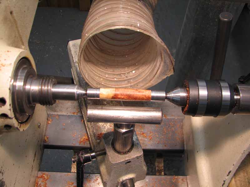

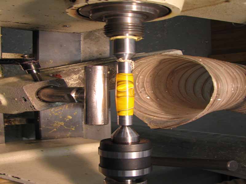

I tried it on softwood, hardwood, acrylic and Tru-Stone.
This is the softwood Holly. As you can see it left the surface kind of rough.

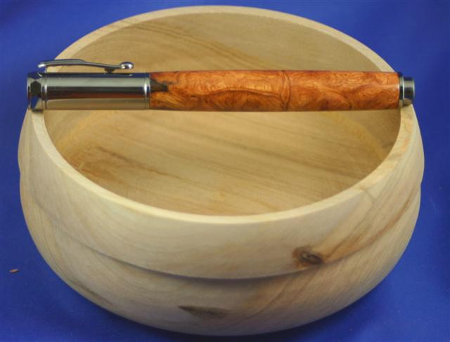

This is Amboyna burl. It made short order of it and I was able to get a fairly smooth finish.

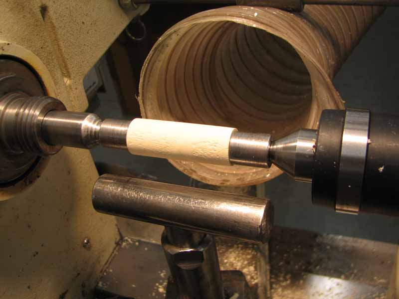

This is acrylic and it also came out fairly smooth.
Sorry about the photo. I don't know what happened and when I tried rotating the photo it made it worse.

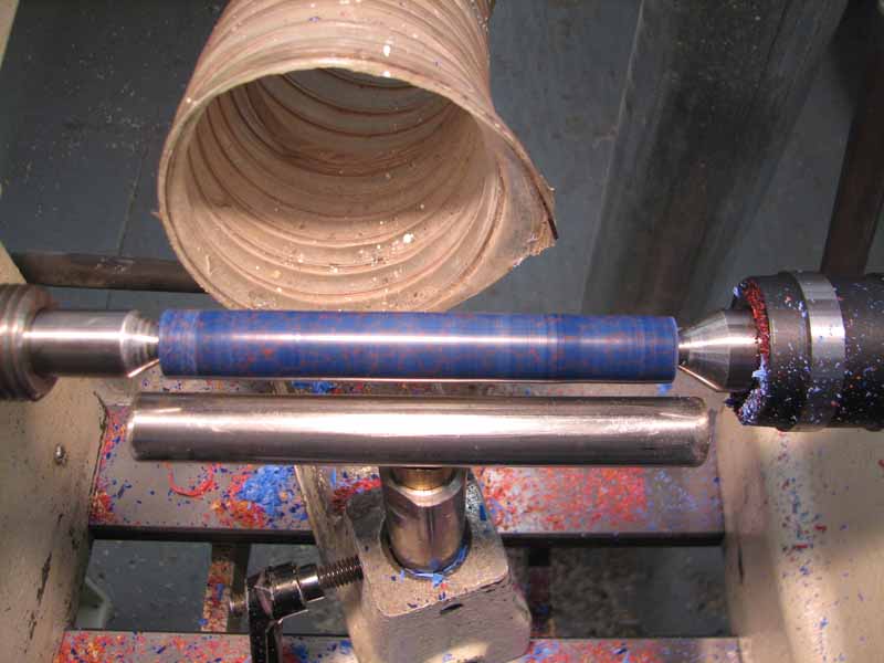

This is Blue Lapis Tru-Stone, probably the hardest Tru-Stone they make. As you can see I was able to get a fairly smooth finish. Those of you who have turned Blue Lapis know how hard it is. I was curious so I timed how long it took to turn this 5" blank to round and I was amazed, 2 min. 45 sec.. With normal tools it takes me about 20 min. to turn one barrel and I have to sharpen frequently.
I found that tilting the tool about 30 degrees and using it like a skew gave me the best results. Hold it like a scraper and it works like a scraper. Dig in the corner and you can remove stock quickly.
Conclusions......
Keep in mind that I used this tool for all of an hour but it doesn't strike me as a shaping tool. Maybe with some practice but not today.
Where this tool shines is with the harder stuff, softwoods are better handled with a skew. It made quick work of the Amboyna and the acrylic and really ate up the Tru-Stone. If you do alot of Tru-Stone you're going to love it but if all you do is wood then not so much.
Am I glad I bought it? Yes. It's one of those tools that you won't use every day but sure are glad to have when you need it. And the BEST part is............................

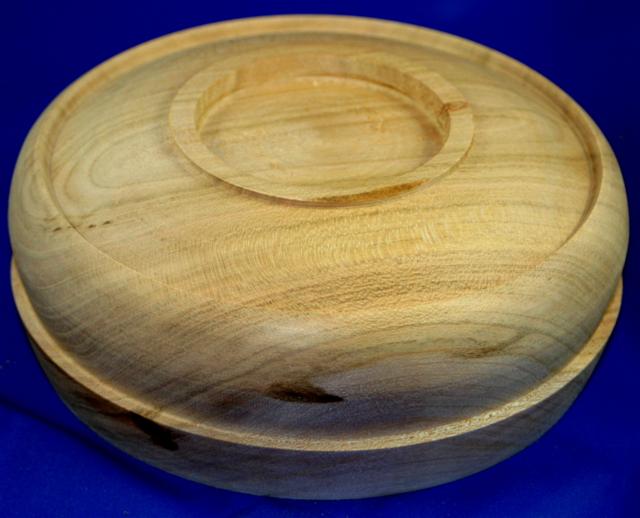

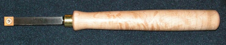

I finally got the handle for my new Skogger made today. I then started playing with it. I also have the Easy Rougher so I was familiar with techniques for using the tool. I did some spindle turning first. I honestly think the Skogger performed better at spindle turning than the Easy Rougher. I don't really know why it should unless Peter used a better carbide cutter. The cutters look very similar. I then turned a pen using the Skogger. I turn pens from start to finish with a skew. After getting the blank to it final (almost) diameter I did my final cut on half of the pen with the Skogger and on the other half with my skew. The two halves were almost equally smooth. The skew cut half was a little smoother but not by much. It was actually hard to tell the difference, but there was just a subtle difference.
I then turned a bowl using only the Skogger. The blank was already bandsawded round. The Skogger did a great job roughing the bowl to round, turning a tenon for chucking and then turning the foot. Shaping the bowl's outside was quicker than with bowl gouges and just as smooth. The endgrain areas showed no tearout. I did apply thinned shellac before making the final cut which helps ease the tearout of the endgrain areas. I was quite pleased with the way the Skogger performed on the outside.
I then reversed the bowl and hollowed out the inside. I again used only the Skogger for the inside. Performance was equally well as it was on the outside. Shaping the inside was more difficult than with bowl gouges. The bottom is flat instead of curved as are the inside walls of the bowl. The Easy Rougher has two cutters with a radius which makes inside curves a bit easier. Maybe Peter could make those available also. I will try attaching the radius cutter from the Easy Rougher to the Skogger to see what happens.
My only complaint about the Skogger was found when turning the inside of the bowl. The handle furnished with the Skogger is a bit short for hollowing bowls. I was able to move the tool rest inside the bowl and that helped a lot. I will probably be making a new handle for my Skogger and I will make the handle longer.
I did not try any plastics. Maybe tomorrow. I may see how it performs on a set of my snake blanks.
I really like the tool and I do not regret purchasing one. Anyone considering the Easy Rougher should just get the Skogger from Peter and maybe consider a longer handle for use with bowls. The pictures shows the bowl and pen I made using this tool. No sanding has been done on the bowl. Sorry, no pictures during turning.

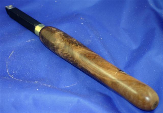

This is my version (at least the handle) thanks to a fantastic walnut blank.
I have yet to turn anything with it as I just got the handle finished but liked it so much I had to post the picture.
the tool feels very well weighted and balanced. I will turn a few blanks in the next couple of days even though how it does on different materials has already been reported.

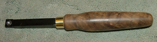

Well, it's officially a tool now. I finally got around to making a handle and trying this baby out, I must say, I think I now have a new friend. This baby makes short, almost effortless work out of rounding up the hardest and meanest stuff I could throw its way. It even made short work of a piece of caribou antler(OMG that stuff is hard) I was making a duck call out of. It does have a slight tendency to catch the antler before it became "kinda roundish" if I put too much pressure to it. After just a short learning curve I have decided the pressure was the problem not the tool. Let it do the work for you(DUH, I'm a slow learner sometimes). Basically I had to just slow down to go faster. All in all I love it. I will be next trying to use it exclusively to make a pen to see if I can go start to finish with the one tool. I will leave the pics to the more photographically gifted. I just wanted to get a quick, honest opinion out there for folks to read. I love it and feel it was money well spent. With more use I imagine it will only become more usefull. Thanks Peter, great tool.
