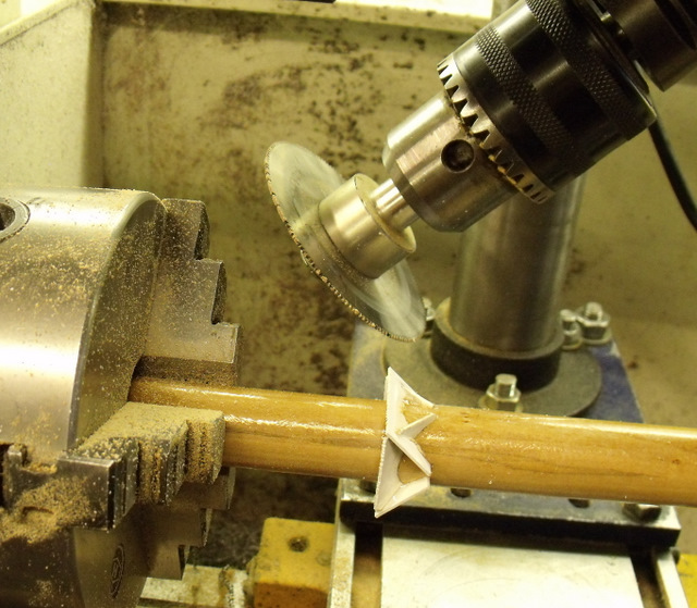

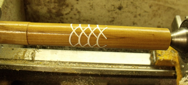

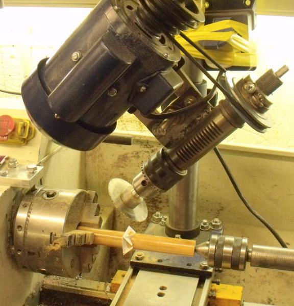

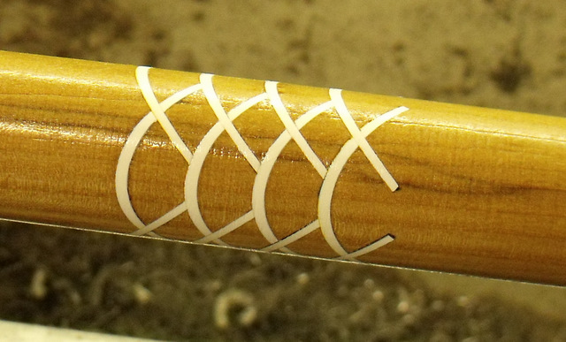

I was messing with the some of my homemade gadgets and re-assembled some of them to make alternative scallops.
This was the results of my quick trial run. Could end up making a pretty neat blank.
Although all the parts are bodged together, I did take a lot of time to set the blade height and to set it to spin parallel to the cross slide travel.
I used a 1mm slitting saw and some white plastic sheet.
This is what I like doing even more than making finished pens:biggrin:

doing the blanks that way also opens up the possibility of cutting then casting if you wanted a webbish look with NO lines....hmmmm..

Absolutely fascinating. I'm going to my local flea market to find a junk 10" drill press. There's usually 1 or 2 a week out there that "don't work"....I never thought of taking the body/lift mechanism and mounting it to the lathe bed.....hummm...the gears are turning and need some grease....

Way too cool. I love the drillpress attached to the lathe like that. Could be used to mill some flats and make your nutless bolt out of plastic........I'll be thinking this one through this weekend. Thanks.

Skip, will a different diameter blank require resetting the blade height to keep the joints touching?

Yes Mike, unfortunately. But it's not a big deal really as there seems to be a range of about 2mm on the diameter 'forgiveness', if you know what I mean. I guess it's 2mm because I used 1mm sheet.
What I'll do is cut loads of different depth cuts on practice wood ( Broom handle) and then turn them down to various pen sized diameters and record the results for future reference.
The starting diameter means nothing
I like Jon's idea of casting into the lines too:biggrin:

You beat me to it!! I was trying to do the same thing. Not as nice of a jig though.
Your pics helped me with some of the difficulties I was having.
I guess you saved me some wasted blanks!!!!
