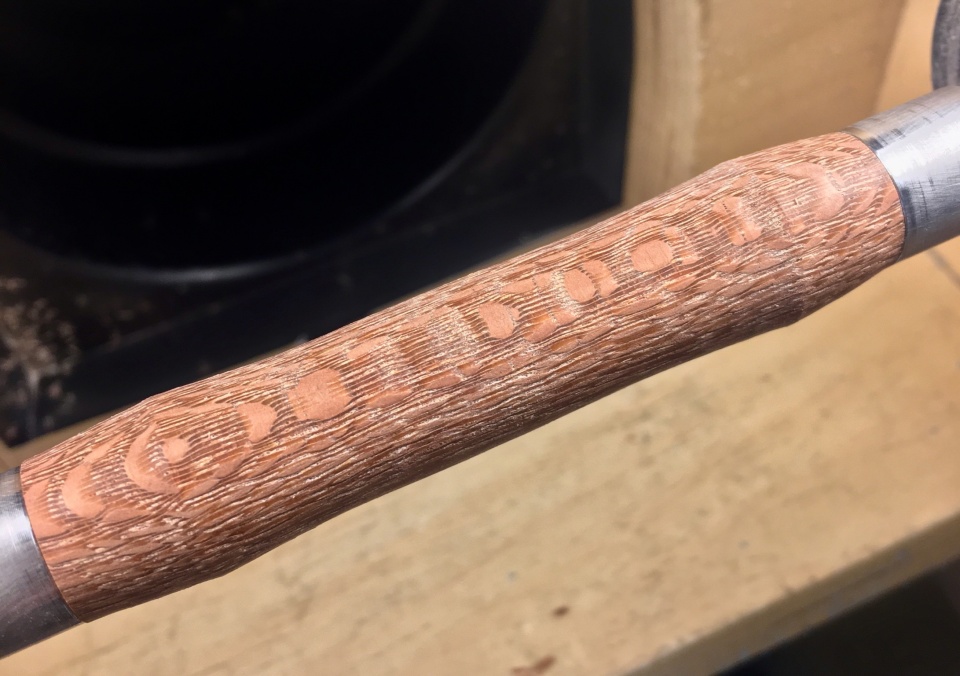

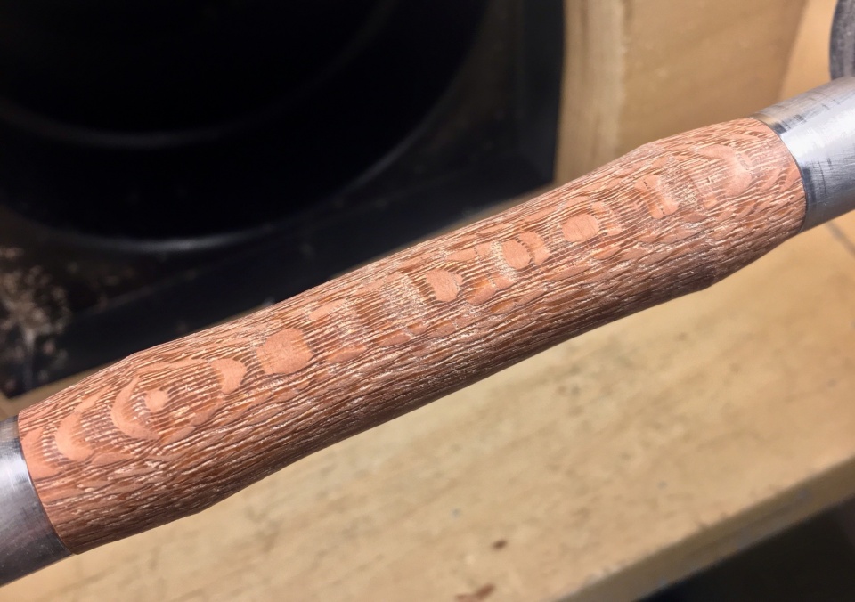

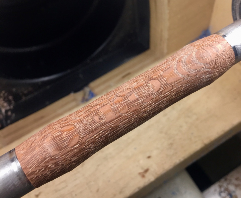

Finally the last 30 or so wood pens have had a chance to meet my skew. The photos show the usually tough leopardwood shave handle before sanding.l straight from the skew. It feels good to the touch with no ray flakes popped out as can easily happen. A skilled turner from the Antelope Valley Woodturners Club gave the group skew lessons and then coached several of us individually. I was a lucky one to get a private lesson. That lesson plus improvement in my sharpening skills made the difference.
I have much to learn but I'm in the game.

Cool. Did he teach you point up or down or both ways?
He could do amazing things with a skew and had it in many directions depending on the task. I use the center of the skew and avoid even thinking about touching my blanks so far with either end. I'll venture farther some time and I'm happy with shaving smoothly across tough wood blanks. Maple burl, leopardwood and crosscut blanks yield to the skew.
