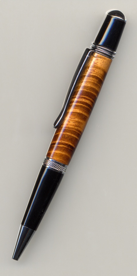

Marietta, Ga. USA
Thanks Gary, do you raise the tool rest at all when doing this and how does it perform on cross-cut blanks?
I do raise the tool rest a bit and cross cut blanks is what I like this best for. I tried some cross cut jobillo once, they were offcuts from a bowl blank, and the negative rake cutting was the only way I could keep the blank from blowing up on me. Four tries doing a shear cut made the grain lift into the cut and peel off the tube, fifth time I raked it and got perfect results.
