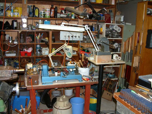

Mike,
With your endulgence and to save me doing this many times I include a few pics to show my set up for pen turning using a VL100 lathe sitting down at a height above the lathe on a draughtsman chair that swivels, I removed the wheels for absolute safety.Like most people I turn occassionally or a lot and in between anything that will hold something gets crowded with bits and pieces. The latest set up has many changes including a whole of garage vacuum dedicated only to the lathe and mounted on the rear wall adjacent to the bench so only a chip separator under the bench. The drive belt is through the headstock to a three phase 415 volt motor on the left hand side ,infinite speed control using an inverter single phase 240 volt to 415v in the brown box. Immediately to the right a pipe stand bolted to the floor has my pen press at eye height and a variable speed lab stirrer mounted horizontally fitted with a small buff.
Foreshortening of the longer lens appears to compress things however to the left swivelling is my design penmill also operated from the chair and immediately behind is my Pen Wizard also operated from that chair.
