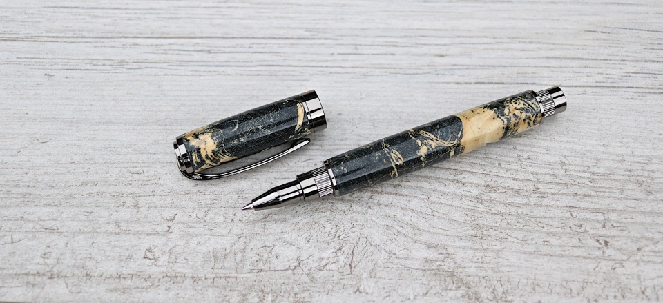

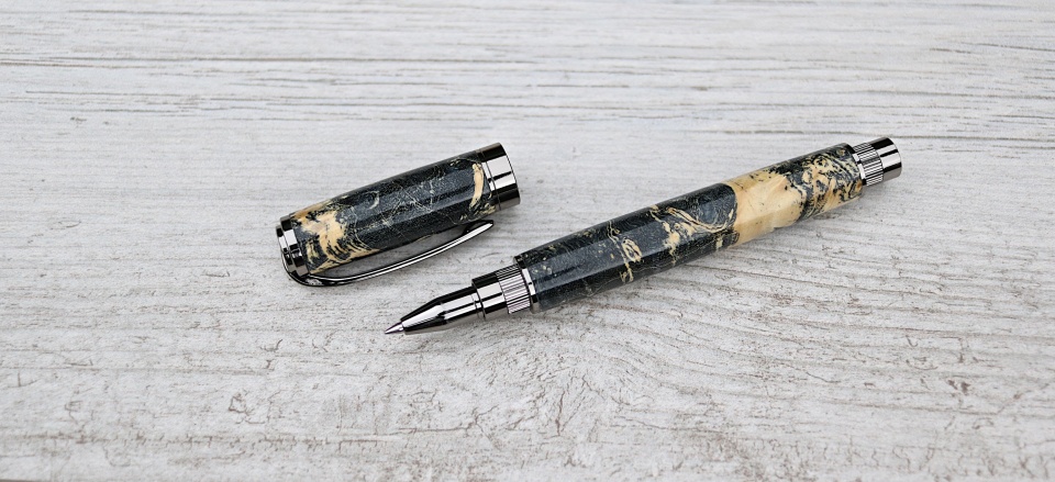

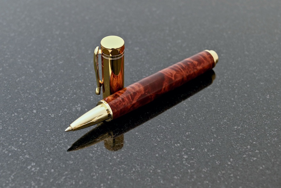

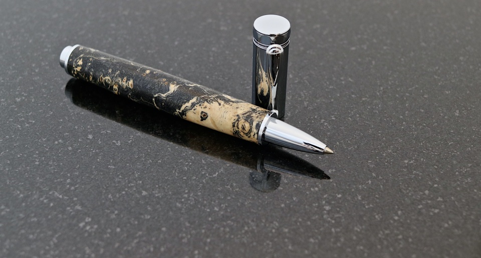

So, I know that to do a proper product photo I need to surround it with diffused lighting, manage reflections, etc. However, since I really haven't found a good spot in the new house to do that I was trying to come up with a way to get a decent photo.
In the past I tried the light boxes and just never fell in love with the look. All one color backgrounds drove me crazy for some reason. Was goofing around on the internet and read about an idea I decided to try.
This photo was taken outside in the early morning before the sun was fully up. That solved most of my diffused lighting needs. For the background I used a $2 piece of wood grained tile. I plan on getting some more woody shades to play with next since I was told this is a bit too stark looking. Camera is a decent Canon T6i and I think I had the little 24mm 2.8 pancake lens on it. On a tripod of course with a bit of a delay to give me time to back away. You can see the reflection of the camera since it's really close. Still, not a terrible photo I don't think.

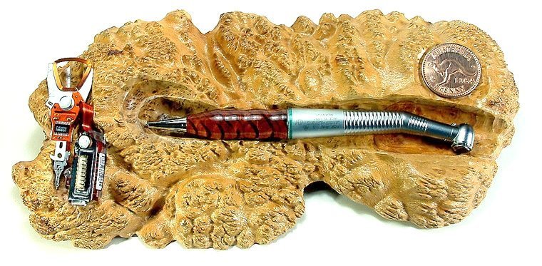

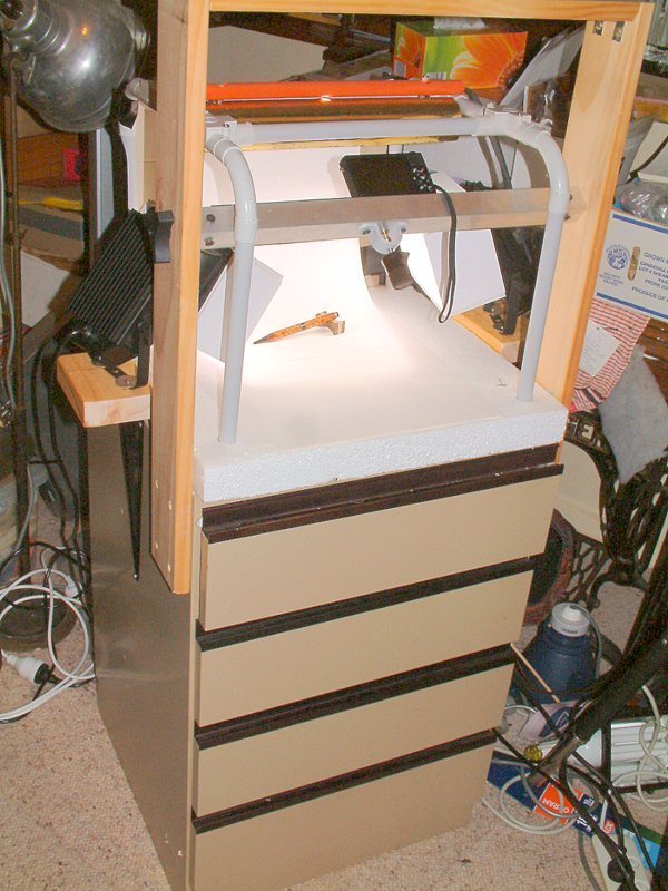

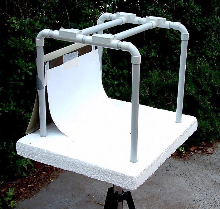

Like your pic your choices. These will never be mine the time consuming method is completely solved by a simple open box. This is ready to go 24 hrs a day.
Mine takes but a few minute.
Kind regards .....Peter.

Peter,
Please post a picture of your simple open box ..... :)

I am surprised it turned out so good ... early morning light before sunrise does not have the right color balance

You make a good point that I neglected to mention. I did correct the colors in the photo. Color correction is relatively easy, it was the abundance of indirect light I was chasing at the time.

OK, thanks for clarifying, Tim. . I forgot that color correction is easy nowadays.

Peter,
Tim,

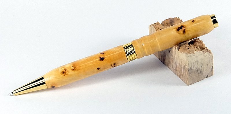

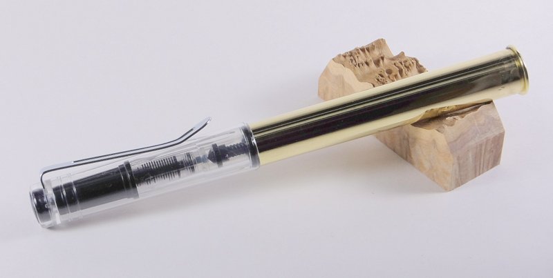

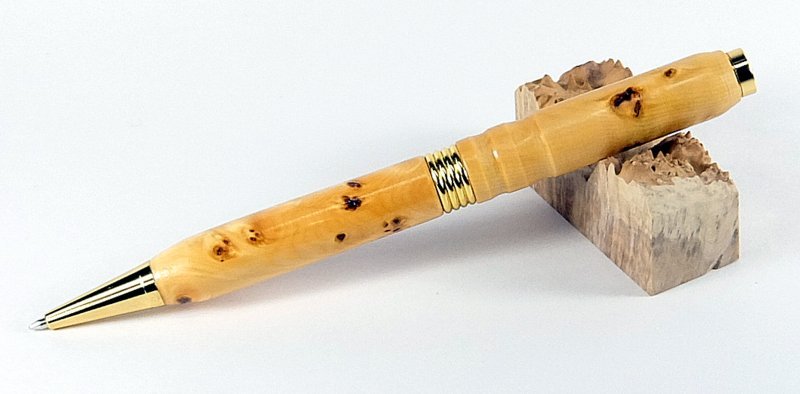

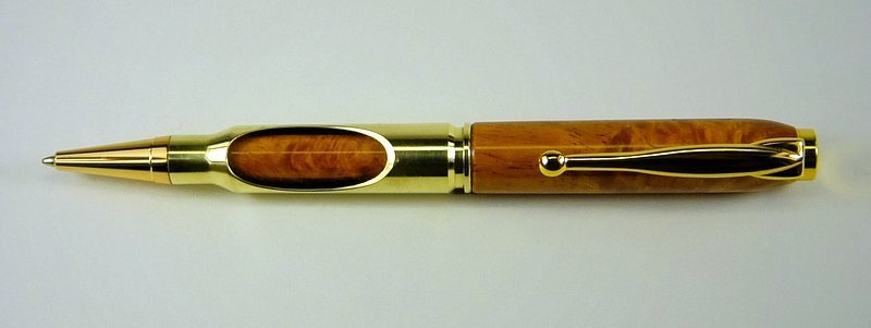

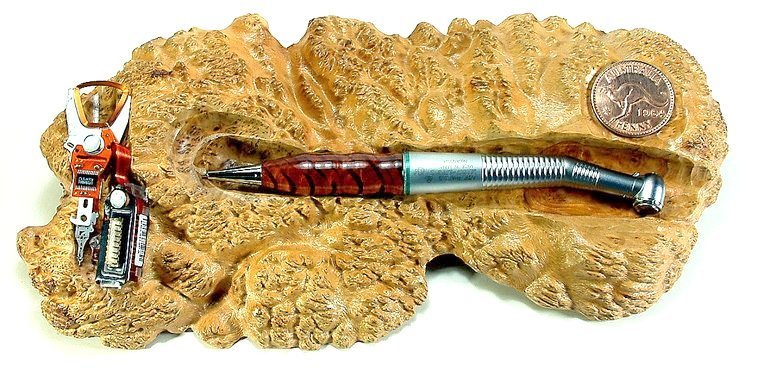

Pics as requested. The last pic the pen in my set up different rest used..
Peter.

Thank you, Peter !!! .... for posting pics of your "light box" and some AWESOME pens !!!!!

Thanks for posting a great picture. It is one thing to post a picture of a pen one is proud of, but it is another thing to post a picture that is clear and draws one in to see the object of the photo.
Too many times, photos are unclear or the background is too noisy or too red or the pens blend in with the background and it is hard to see.
I can handle one color background as long as they support the main point or give attention to the main point/pen.
Thanks for bringing this subject up! Well done.

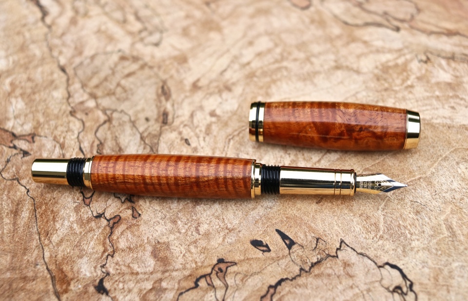

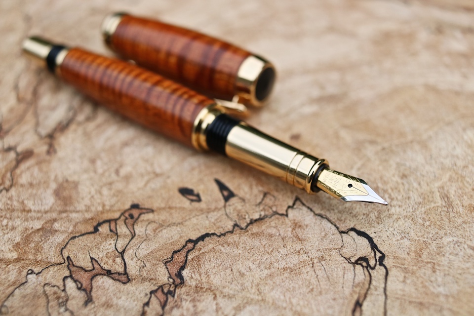

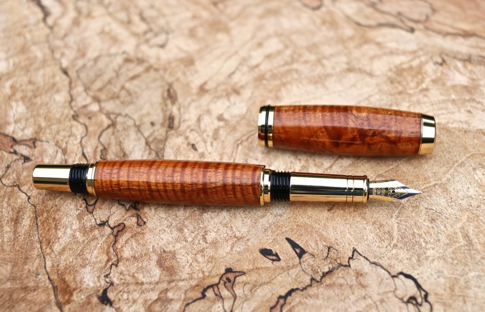

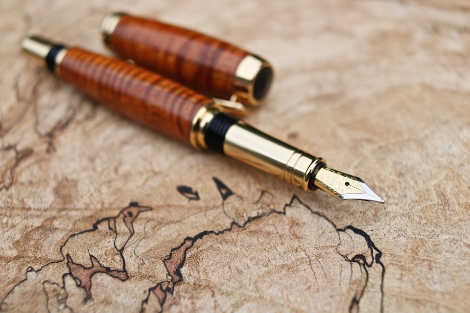

Was playing today with a different background... Couple of people said the grey was just too cold/stark. Went outside with a nice piece of spalted maple and shot these two pictures. Absolutely 0 white balance adjustment post processing. Little tweaking for definition and touching up the exposure but that's it.
Again, I'm not saying this is the perfect solution but you CAN get good photos with natural light and a decent camera on a tripod.

Holy cow what knock-out pens you posted (both)! :)
As a hobby photographer, I love artistic shots and the close-up bokeh shot of the fountain pen nib is just wonderful! :) (good to have another picture which shows the wood better too, though) :)

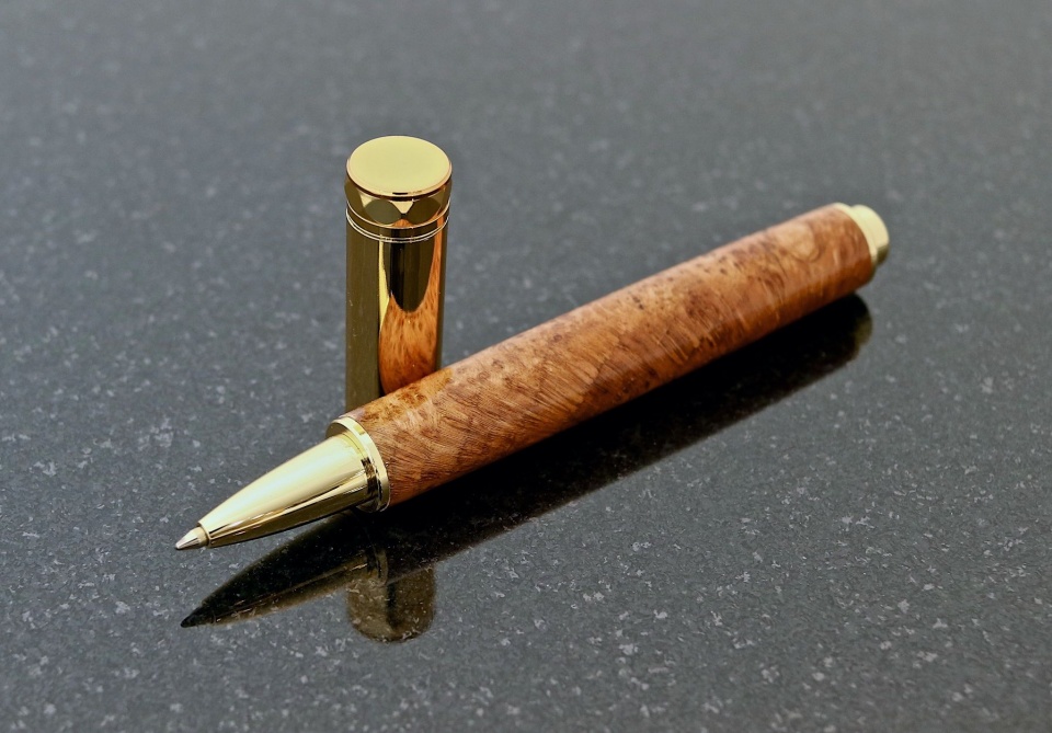

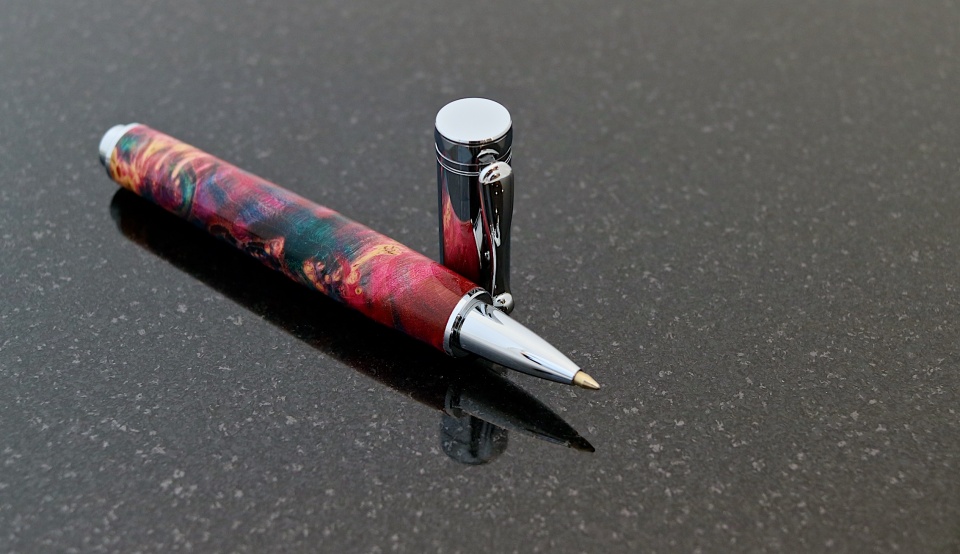

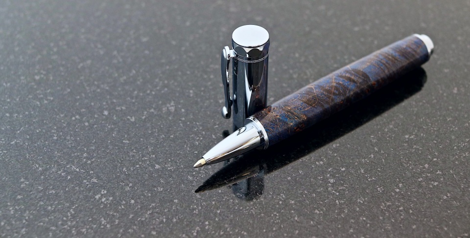

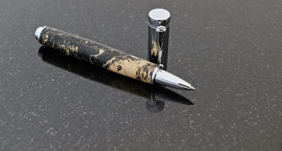

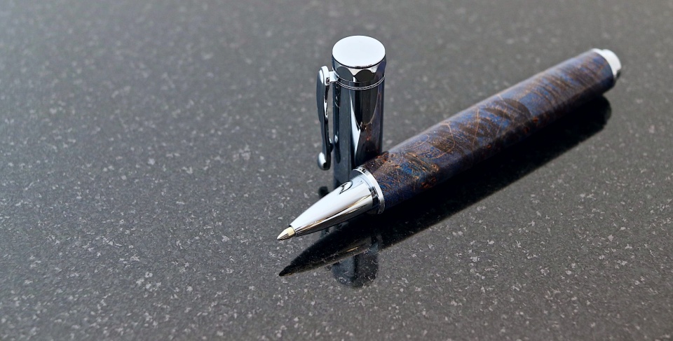

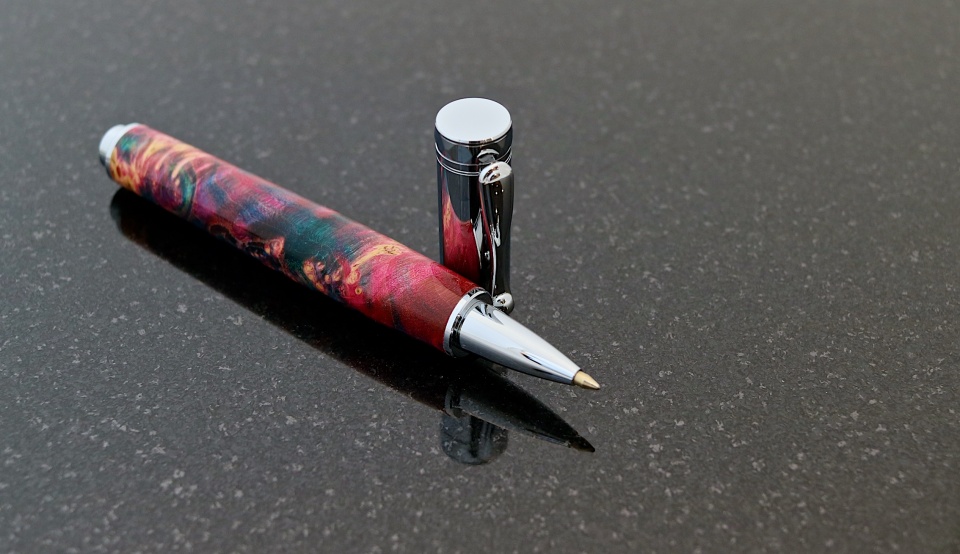

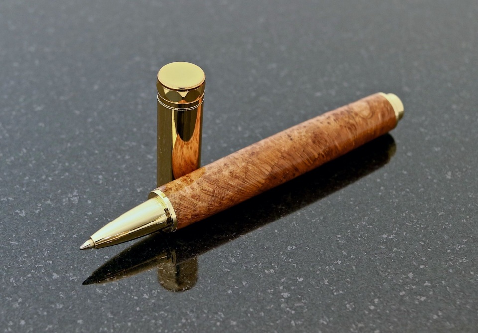

Today I got bored and decided to pull out a granite tile I had purchased a couple months back just for this purpose. Camera was on a tripod with a timer like before. These were actually taken indoors with no extra lighting but I did stick the tile inside one of the pop up photo tents. For a shiny surface like tile you kinda need a tent (could just be a strategically hanging sheet, or just white paper/cardboard) so you don't get any funky reflections. The tent was just placed on top of the kitchen table near the windows to gather what light I could from outside. Regular house lights were on but I didn't do anything special other than that. Took just a little bit of auto color correction and I could tweak the colors a bit more but didn't want to mess with it.
Not my best turning work but these are what I needed to take pictures of. :tongue:
