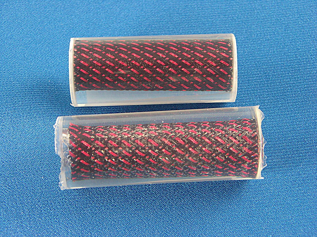

I think I have discovered what is causing the silvery patches in my tube-in casts. I did an experiment where I coated the CA saturated braided sleeves and denim with different materials. I heated them in an oven and heated the PR before mixing (4 drops per ounce). I then left them in the pressure pot for about 16 hours. When I took them out some of the casts had the silvery patches and others developed the patches during the next few hours. The resin was still quite pliable and when I sqeezed the tubes (vertical casts) the silvery patches increased in size in some areas and decreased in size in others. This tells me that the patches are areas where the resin has pulled away from the cast tubes. I think I need to increase the cure rate and/or leave the molds in the pressure pot much longer so that the resin is not pliable when the pressure is released. Any comments or suggestions?
Note: My work area is 50 - 60 F so it is difficult to keep things warm. I use a paddle stick with a drill to do the mixing.

My thoughts again on your use. Let me ask when you say coated CA on braiding and denim with different materials, what do you mean?? Have said a few times I do not like the CA use but that is just me. Next is you are flirting with too cold of temps. Poly resins like 65 to 75 degrees. next is buy yourself an old toaster oven. Does not have to be a good one. You can find at garage sales and also dent sales. I bought mine from Walmart as a dent sale and got real cheap. This is how I heat my resin. The more catalyst you add the more brittle a blank CAN become but not always the case. I use 5 to 6 drops in my mix and find that to be just fine and I cast 1" round molds. If you use color dyes you will need to increase cat. Mixing, not a fan of any type of electric drill mixing. You are adding air bubbles to mix. I mix by hand for about 3 to 4 minutes going both ways with a plastic cup rated for resins and popsicle stick. Making sure I scrape all sides also of the cup. The larger the pour the longer the mixing time. 16 hours in pot should have been enough time to harden molds. I believe your temps are holding this back and thus you need to leave longer under pressure or increase temps somehow. You can take molds out of pot and put in toaster oven to complete curing and remove sticky stuff. This is what I do. If you press on a mold that is not fully cured you fractured the bond and it will craze on you as you are seeing. To sum up I believe your temps are the root of your problems. As mentioned before moisture from items as well as humidity can effect the cast. Good luck.

As Don said sometimes you never will figure out what went wrong I too have had some casts just look like yours and have no clue. Same pour, same resin and same time in pot. I showed an example the other day of one I did not long ago but same effect.
