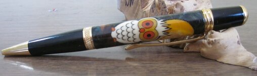

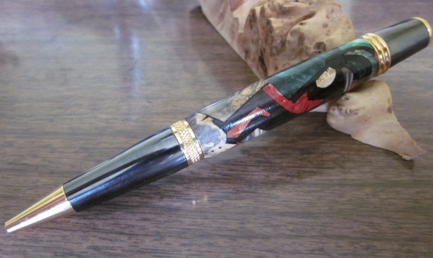

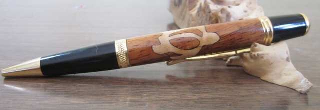

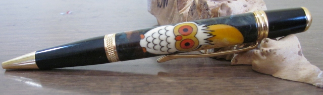

Hello,
Let me first say I am extremely disappointed in this kit. I have made 4, all $30-$50 laser inlay kits. On all but 1 of them the shiny black part on the nib end has come lose and now rotates freely. Needless to say, I will not be making anymore of these kits. But as for the ones I have, is there any way I can fix them and stop the black piece from rotating?
Thanks in advance,
Nick
biednick
Jul 13, 2010
333
Hamilton, Ohio
A picture would help identify which version of the many that call themselves "Sierra" you are using.
Its the Berra version, not he Sierra Vista, some from Exotics and some from Arizona Silhouette.
