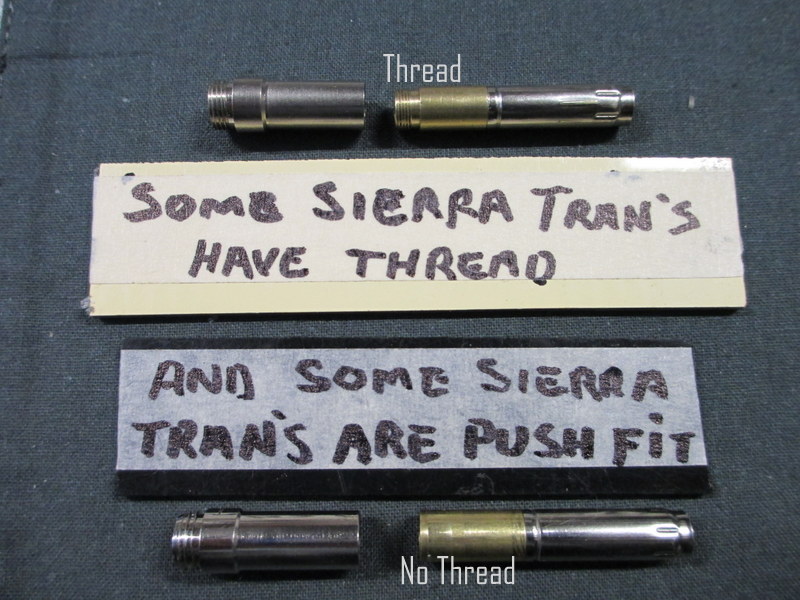

There are different types of Sierra transmission connecting housing, one is threaded,and some are a push fit not threaded,check to see if you can unscrew the transmission from the housing if you can't unscrew the trans its a push fit and can be adjusted using a pen press/vice. a lot easier than trimming the blank.

Sierra Transmission push fit and screw in fit.
sbell111
Jan 16, 2008
3,465
Franklin, TN
They both screw in to the nib section, right?
I see where you are going with having limited ability to regulate how far the refill extends by adjusting how far the actual transmission is pressed into the adapter, but that's little different than locking down the screwed in transmission if the refill is extending too far and really isn't an option for those refills that don't extend far enough.

Thank you, John. The twist mechanism screws into the nib assembly at the bottom and presses into the clip assembly at the top. As the extent of writing tip protrusion is determined only by (1) the depth of the screw thread and (2) the amount of travel in the twist mechanism itself, I don't see how the length of the turned blank is relevant. In the context of my problem, (2) is undoubtedly the cause, as replacing it with another twist mechanism overcomes the problem. Having said that, I think I could probably fix it 'Heath Robinson' style by trimming two or three milimetres off the entry end of the female thread on the nib assembly. Hardly worth it though, just to save the cost of a twist mechanism which I'm sure Timberbits would replace, anyway, if I bothered to return it to them.
