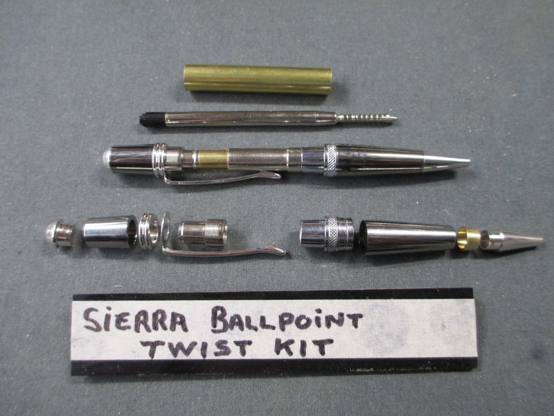

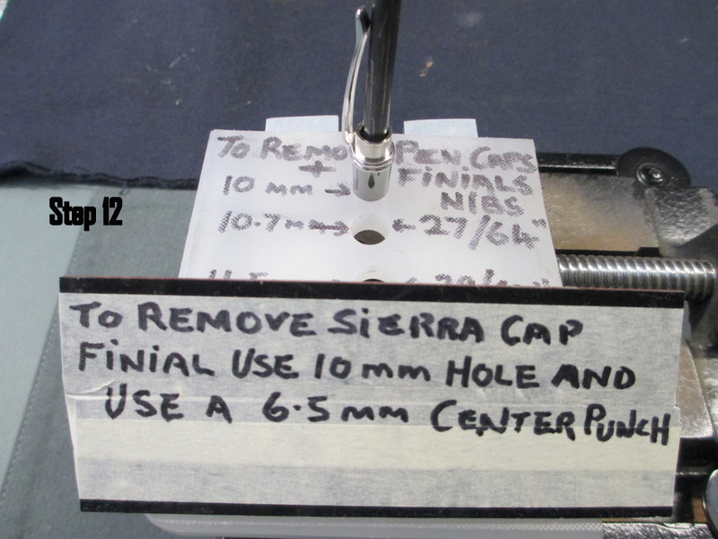

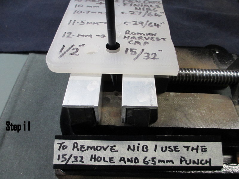

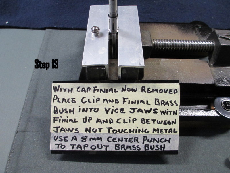

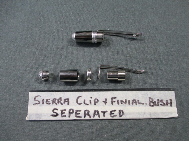

To remove Sierra clips you need a few tools
1)bench vice i raised mine up 3/4 inch and cut some aluminium angle to go over the jaws.
2)plastic cutting board with different sized holes drilled in it,the cutting board is used on top of the opened vice about a inch is ok.
3)You need 3 Center punches 1 for body,1 for the end cap 1 for clip bush.
1st remove clip end from body.
2nd place end cap upside down in the 10mm hole,using 6.5mm center punch knock of end cap
3 place clip between vice jaws use a 10mm punch and punch out brass bush the
clip will come of with the brass bush.you could wrap tape around the clip to protect it.
