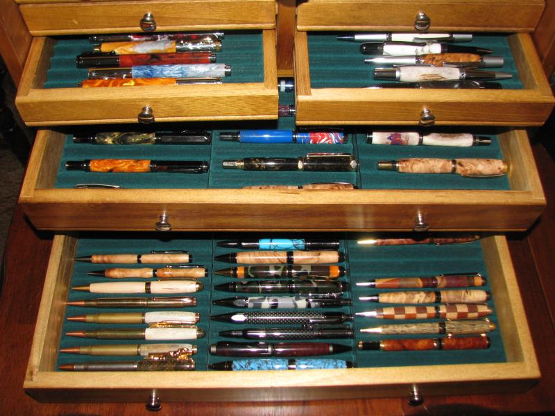

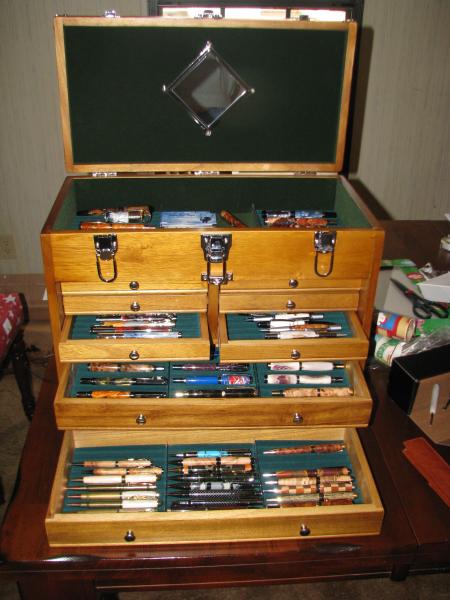

After looking into building or buying something to show off and display my pens without going broke. I put this together A couple weeks back for my personal collection. Picked the tool box up at HF on clearance. Modified it with display inserts. Holds 159 pens. Showed it off at our chapter meeting last weekend, seemed to be a big hit. And the best part, I only have about $75 in it.

This is really a cool idea. From locked up and stored, you go to instant display cabinet. I wonder if you could put thin plexi-glass panels over the drawers when they're open, to keep fingers out of there, when you're not watching?

That is a fantastic idea. Looks great. When I worked at Woodcraft they sold one for ALOT of money and the floor display warped before it could be sold. That one looks great. Maybe it will increase your sales.

Thats it Scott. When I went to buy it was the only one they had and was on clearance because it was missing the keys. I talked them down to $30. I bought the trays from Gopens.com and cut them to size to fit the drawers. On the two large drawer you have to cut the trays into 3 pieces due to the size of the trays. I used the plastic corner guards you use on dry wall to divided the sections. I got them at Home Depot for $1.99, there in the paint section. The only thing I may redo is making my own trays for the smaller drawers. The pre made trays are perfect for smaller diameter pens, but for larger capped type pens, it gets a little cramped. As far as the quality, its actually pretty good for being made in China and for the price. I'm actually considering buying another one to keep some of my rare straight razors in.

Finding one that isn't beat to heck in the store is the first hurdle. Craftsmanship is non-existant, but for HF it isn't the worse. We looked into doing these and could not get one case out of five at the store that was worth more than firewood. When we found one that the wood was OK on the fake felt was grued on wrinkled. Solution? We picked up an old machinist's chest. I still have to refinish it as it came in just before Christmas. Really neat early chest without the drop front.
