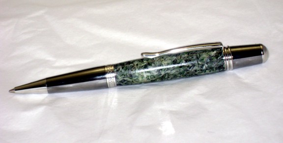

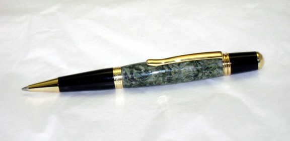

Okay, how about some shredded money. Here are two different styles of Wallstreet II pens with the shredded money blanks. The blanks where purchased out of Arizona Silhouette.

The pens look pretty good from those pictures but there's a little bit of a glare. I heard that Ed's money blanks (what you used) can have bubbles to work around, did you find this to be true? I have a couple of these same blanks that I'm waiting for divine inspiration to turn.

Yea, they did have bubbles, after a while it go a bit irritating. I had to keep using CA after some sanding because the voids kept popping up.
I was probably irritated more because I'm not being very patient right now.
