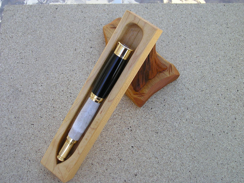

Here is a PSI kit - "Over-Under Shotgun Roller Ball" (PKCP6000). It is a big heavy pen and has appeal to the "outdoors" crowd. It was made for my FIL who is an avid hunter. I plan to present it to him on his birthday. I used antler for the bottom and an Aquapearl black blank to simulate the 12 gauge shotgun shell (top). A fun to make kit and best suited as a desk pen IMHO. Hope that you enjoy the view and for any comment(s) that you may wish to leave.

Very nicely done. I have been looking at that kit for some time but I am not as advanced in my skills to feel comfortable in trying yet.
Could you comment on how you trimmed / squared your blanks. I assume the tubes are a fairly good size diameter (??????).
Thanks - awesome looking pen.
Dan

Hi Dan,
the blanks were squared using my HF transfer punch and my aluminum sander block (see link below)that is mounted on the headstock. I DO NOT use a trimmer any more since I did not get the positive results that I'm getting now by "sanding" the blanks.
http://www.penturners.org/forum/showthread.php?t=52379
The upper brass tube is 0.535" whilst the lower one is 0.450".

Great job on this pen Peter . I love the color combo/contrast . Just an observation , the body blind cap/tail piece looks kinda out of place . Since this is a big heavy pen and will most likely be used as a desk pen , there is no reason to post the cap so I would suggest that it be made as a closed end pen . I think it would balance out the look and probably feel of the pen . In no way is this a critique of this pen , just a suggestion for the next .

Well the materials don't hold a lot of appeal to me- I think you know my feelings about working with antler- it's just kind of creepy! But I do appreciate the appeal of antler pens and this one did come out great. I also like the stand and the holder for the pen. Did you make those as well? Are you giving it to him as a complete set so he can display it like you did in the bottom picture? That would look super cool sitting on a desk.

Nice work Pete. I think it looks really nice. PSI has done a great job with their simulated ammunition. I'm not crazy about the shotgun clip, but other than that, I like it. I would agree with making it a closed end pen too, but customers tend to prefer postable pens, even if it isn't comfortable that way. I still say though...I made my shotgun shell pen way before PSI made these! Mine is much larger, but hey..it's the real deal! Can't say they got the idea from me..I wouldn't know that, but if they did, I'm flattered.:biggrin:
