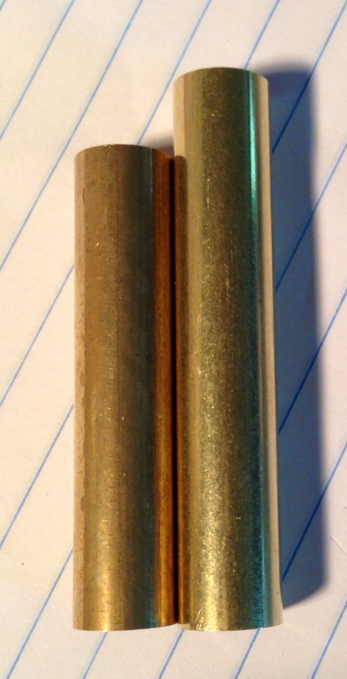

The "Elegant Beauty Button Click Sierra" is also shorter. I don't have my calipers handy but with a tape measure it looks right at a 1/4" in difference, maybe a 1/32" or 1/16" more.
The library indicates that the elegant beauty click sierra is 1.89 in while a typical Sierra is about 2.25 (some a bit longer) so it would be a little more than a third of an inch shorter
