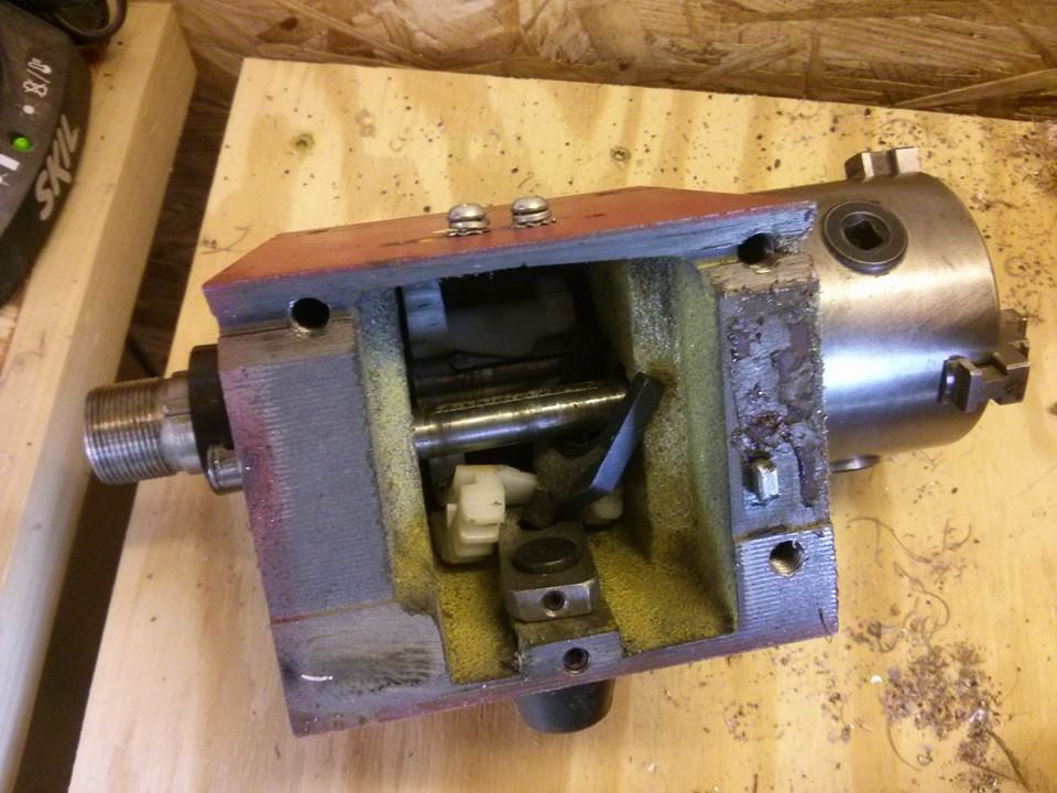

So this little HF 7x10 was used. It had a slight clicking in low gear and a very pronounced one in high gear.

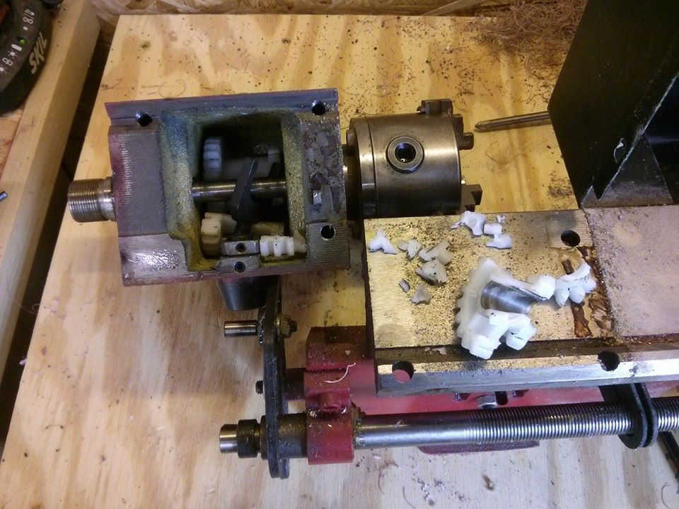

Well today I flipped the switch and didn't notice that the tool post wasn't exactly clear. The jaws caught it and seem to have completely stripped out the transmission. Motor spins but it won't engage the chuck.
Took apart as much as I could find to take apart but there doesn't seem to be any access into the tranny. Not sure what to do now :frown:

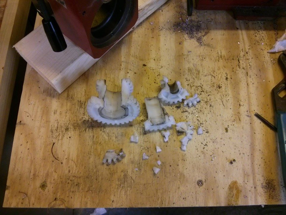

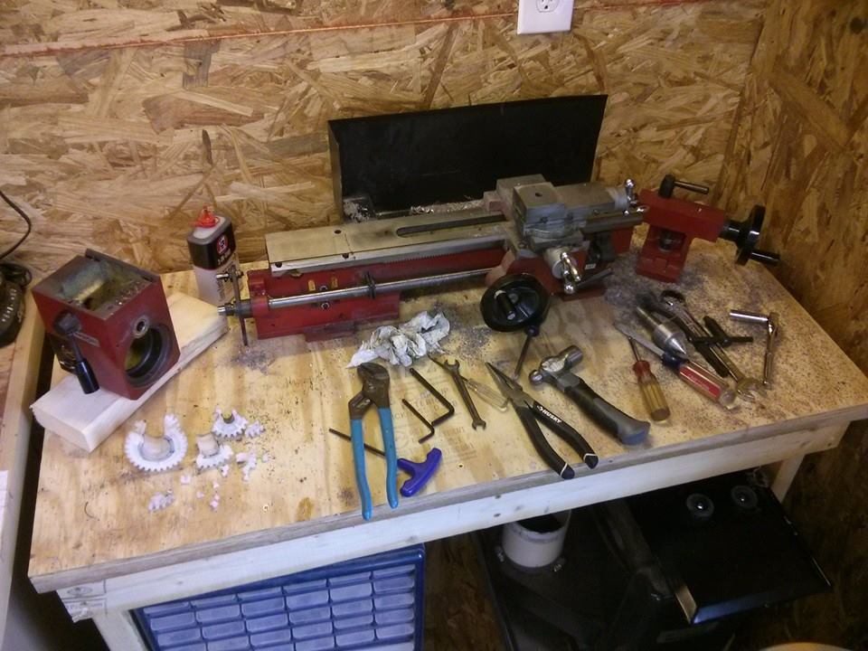

My fault for crashing it. I thought I was clear but I must have moved it again between checks as I was working on checking the overall alignment and was bumping it a bit here and there.
Found some references to a broken key way when it gets crashed, but so far no help figuring out how to actually get into the head stock to see what's in there.
Carl Fisher
Jun 7, 2011
2,761
Cape Coral, FL
Sigh :frown:
Off to search the web and see if these gears are available for purchase. Hopefully LMS can point me in the right direction if they don't have them.

LMS should have them in both plastic and metal. I wouldn't upgrade to metal unless you are really sure you won't crash it again. The gears will be a pain to replace, but they aren't that expensive. Using metal gears as a replacement could result in something a lot more expensive breaking if you crash again.
Good luck!
First the dropped blank. Then the lathe crash. If these things come in threes, it may be time to take a break.......

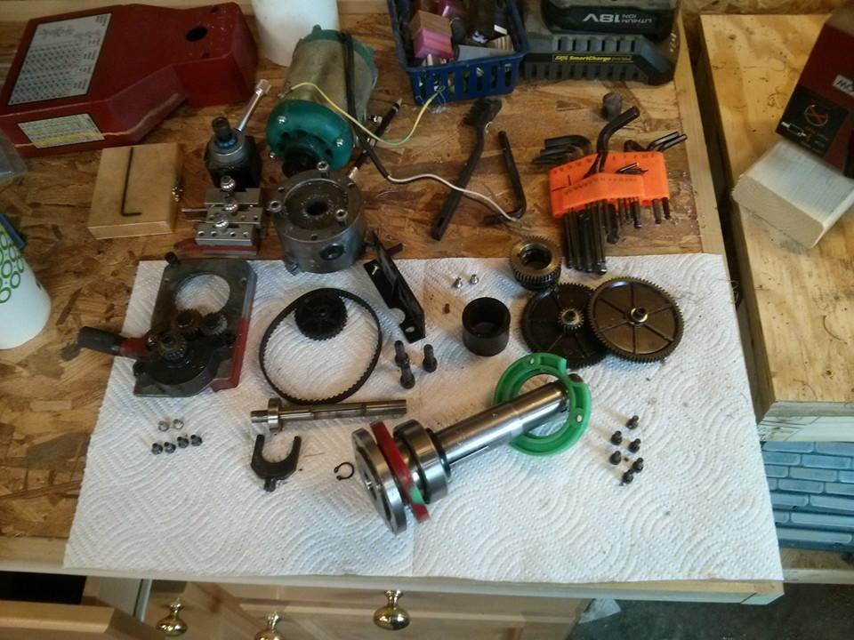

As I was taking it apart I was noticing just how easy it would be to get the whole thing out of whack on the alignment. For a precision lathe it's not very precise with the methods of adjustment. Kinda take it apart, make a change and then take it on faith that it was a good change.
LMS had everything. I ordered a metal upper and a nylon or plastic lower. I'll leave the lower as the sacrificial since it's easier to remove the intermediate shaft than the main shaft. I'm surprised that the belt didn't give before the gears though. I'd rather replace a skipped belt or pulley gear than take the whole headstock off again.

Now to try to remember how it all goes back together:frown:
Kryn
Carl Fisher
Jun 7, 2011
2,761
Cape Coral, FL
Yeah, that would be rough to wait on.
The only thing I'm not sure on reassembly so far is the positions of the 4 wires to the control panel. I know which side is motor vs power, but what I don't recall is which way the white and black wires went on each individual switch.
