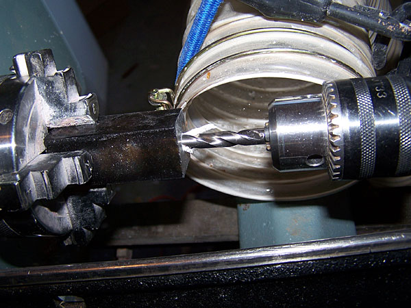

I have a HF dust collector (loud) with hose running to Shop Fox Duct Collector Stand behind the lathe. There are cheaper and better alternatives to that stand.
I am more concerned with dust collection whether turning or sanding. Depending upon what am turning can adjust the stand to pick up some chips but not all. It does a great job of dust collecting. I do sweep up chips after finishing for the day and go over area with shop-vac.

I also have a 16-gallon shop-vac, use when drilling on the lathe for chip removal and shop clean- up. One hand turns tailstock wheel in and out, other holds shop-vac nozzle to remove chips. I have the filter and bags in my shop-vac.
I could not live without either piece of gear.
