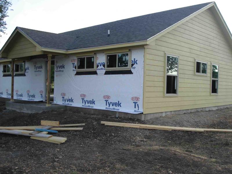

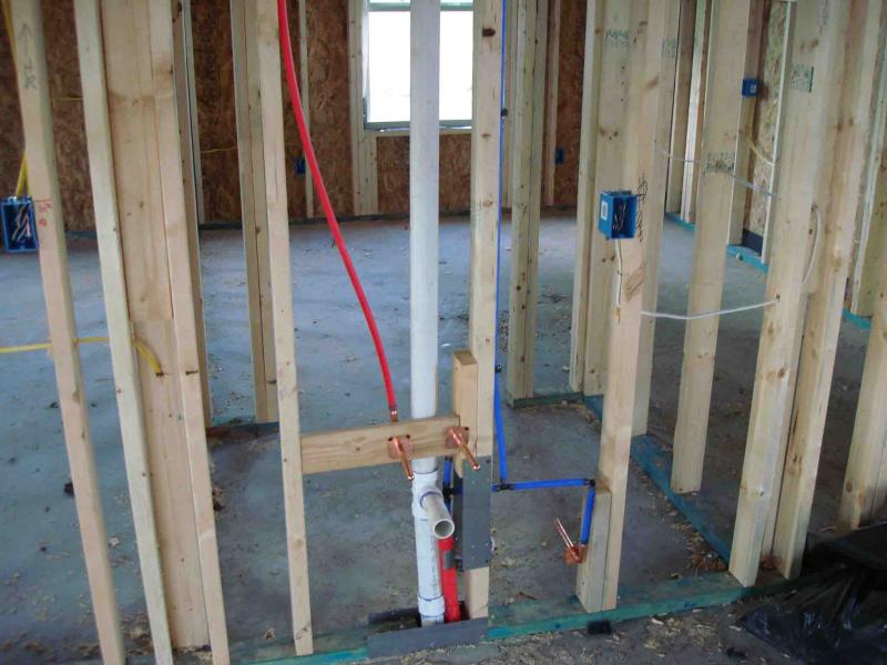

We received the windows early and had an opportunity to get them installed. Completed the electrical and rough plumbing this week along with getting the roof and siding installed
Next week should have the foam insulation sprayed in and the sheet rock completed. I hope to get the rock and brick on the front over the next 2 weeks.

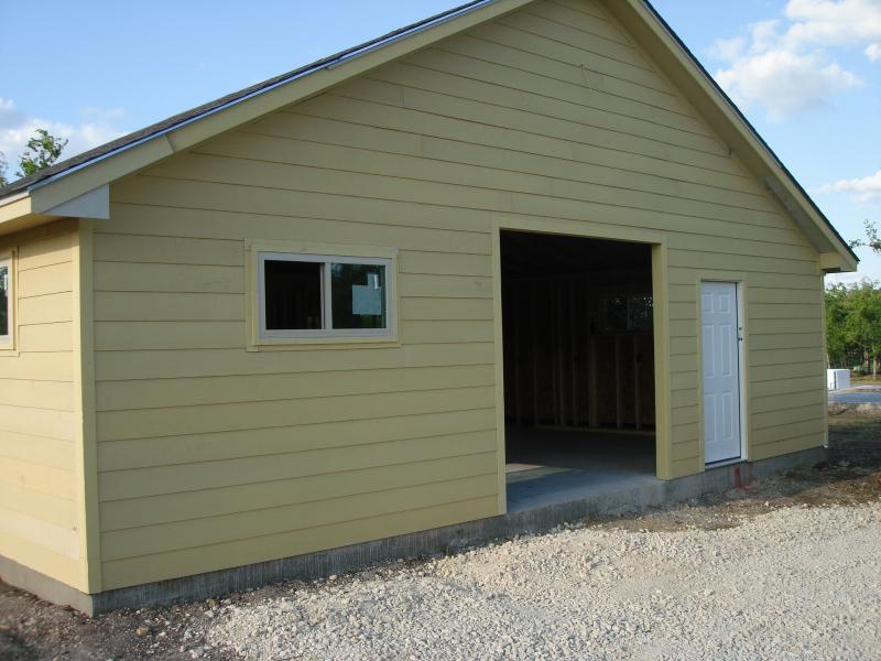

The 8x8 roll up door gets installed Friday. Hopefully, everything will be finished in 2 more weeks.

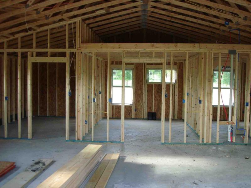

The area above the rooms had additional ceiling joists added and then decked so we can use this space for storage. We need to add water connections to run lines to each end of the building for water faucets outside. We'll add a valve under the sink so we can turn off the outside faucets and open them to drain during the winter to prevent freezing.

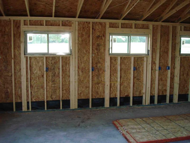

There are seven 220 v circuits on separate circuits. Two of the 220v circuits are in the ceiling and will allow me to drop lines to the center of the shop. I've found retractable cord reels to use along with retractable air hose reels. The equipment room has a 30amp 220v outlet for the dust collector. The lathe room has one 220v outlet for a window A/C unit or for tools.
My wife thinks I have too many outlets. I could probably use a few more, but I have enough for the cost factor. We have 110v outlets about every 3-4 feet in most of the main shop and the lathe room. The equipment/storage room has a couple on each wall. The office has outlets spaced around the room as needed.
