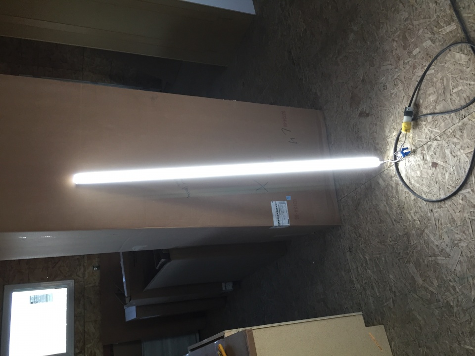

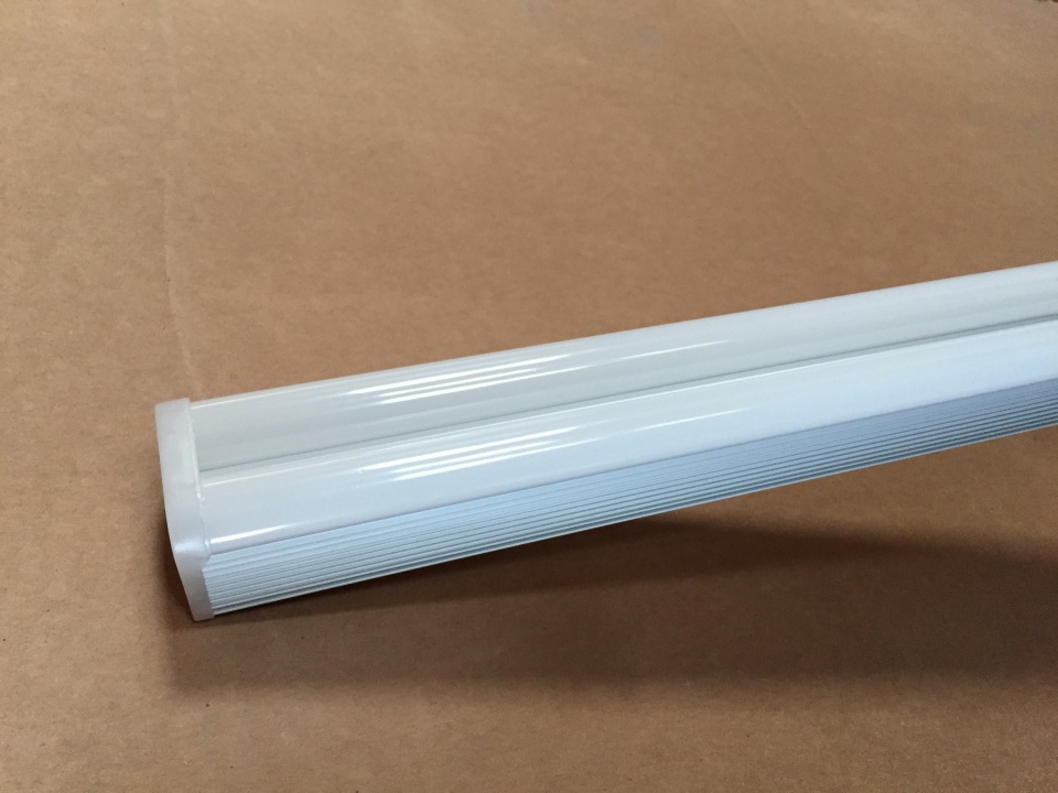

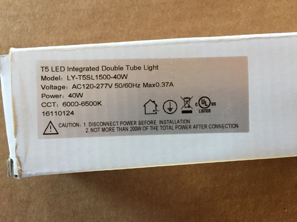

A week ago I received 22 fixtures I found and purchased through alibaba.com, a Chinese selling site. From the time I ordered until the day FedEx delivered took three weeks. The site is geared towards business but many will sell small numbers of lights to individuals like me. The company I bought from is Lonyung LED Lighting Co., Ltd. The light model number is LY-T5SL1500-40W and cost just over $18US each. Shipping was about $180US for a total of $570.70. When the package arrived in Canada I had to pay another $36Can for brokerage and tax. That is about 1/2 to 1/3 of what I can get lights for locally. Since virtually all LED lights are made in China I don't mind cutting out the middle men and buying them direct. The lights are 60" long x 1 1/2" x 1 1/2", 40 watt equivalent, and come with a cord to wire direct to the mains or put a plug on along with another to connect multiple fixtures to a total of 200Watts, and mounting hardware. One thing influencing my decision to buy form Lonyung was that they were certified by UL for both Canada and the US. My electrician can't legally put fixtures in unless they are approved. Many companies aren't. The lights will be going into the garage and workshop soon. :)
Curly
Nov 20, 2010
4,850
Saskatoon SK., Canada.
A couple pics from the phone.
Note the wiring was just for a quick check to see what I bought. They will be properly wired when installed.

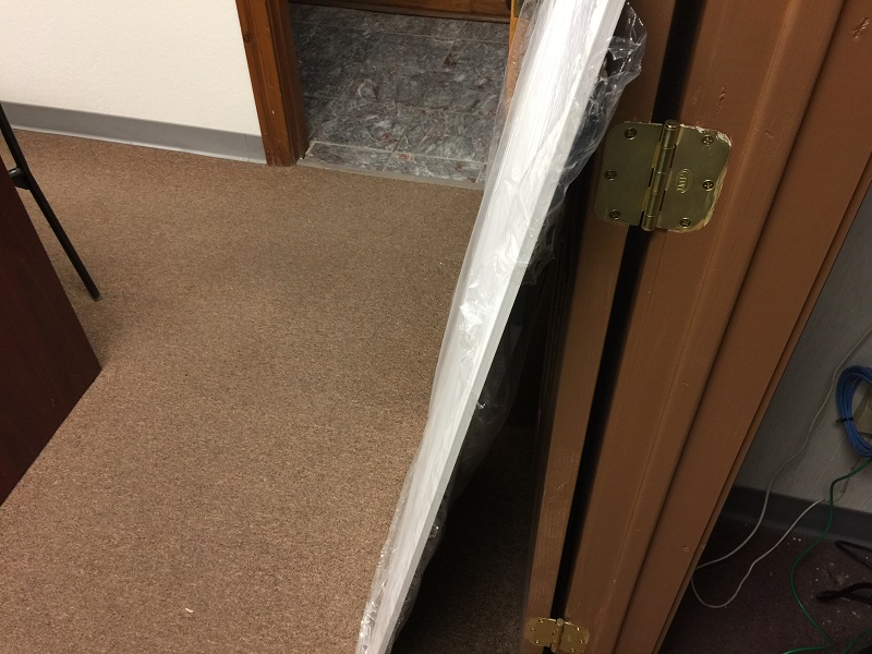

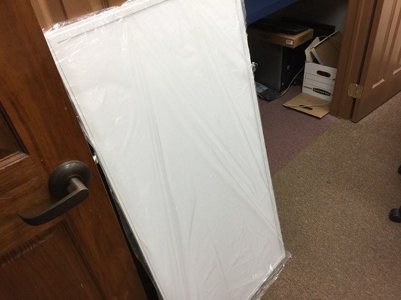

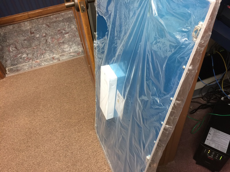

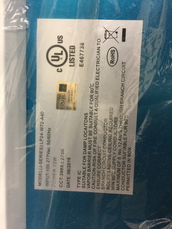

I am fixing to get a building for my shop built and hauled in. I am putting 4 of these lights in, generously donated by my boss as they were extra from a job. These are dim-able LED panel lights. He actually ordered non dim-able but they sent these since they were out of stock on the non. They are daylight white and very bright. 2' x 4' troffer light size and 3/8" thick. The cost on them was 87.00 each. Dim-able were a little more but we were charged the cheaper price. Sealed unit so no bugs or dirt getting inside

There has been some issues in Texas Schools with non-UL listed LED bulb replacements causing fires.....In my office, we have retrofitted existing lay-in fixtures & removed the T-8 energy saving ballast..the new lighting is brighter & we reduced the energy (amp load) by 50%.....I personally would not want to use the LED bulbs that use existing ballast....

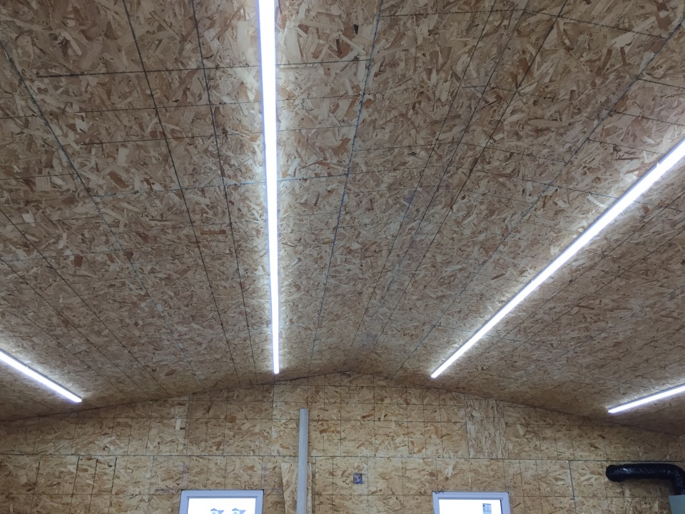

I had mentioned on this forum some time ago that my wife and I were planning to move from PA to NC. Well...it's happening! We're in the planning stages now for our new home. Part of that plan includes my shop. All you folks have convinced me that LED lighting is the way to go.
I did a little searching and found that you can get LED T8 bulbs cost effectively when purchased in bulk. The fixtures seems to be another story. I could not find a source for T8 troffer or suspended fixtures without bulbs or ballasts. Seemed like this would have been the lowest cost way to get all the fixtures I'm going to need. Salvage sources might be an option to find units I can retrofit.
Curly
Nov 20, 2010
4,850
I'm happy with the lights I bought and doubt you'll find it much cheaper at $26US per 40watt fixture delivered to your door. Marla says they are too bright. :) PM me and I'll send you the company name to look for on Alibaba.
Just think when you paint that ceiling white how bright it will be.:glasses-cool:
