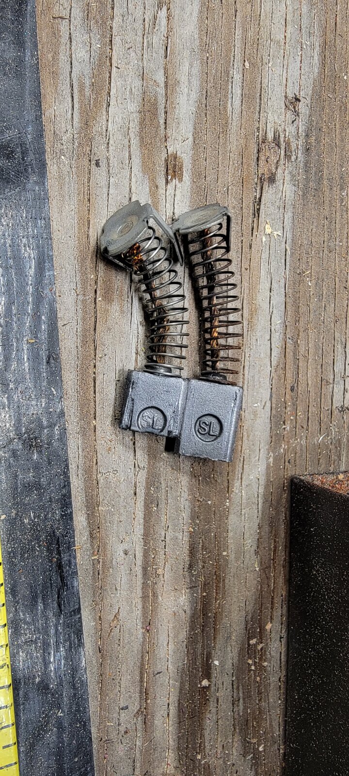

A couple people had mentioned brushes to go along with my check list and yes this is also a possible cause and easy to check. Pull them out and look at condition and shape. Probably a spring on them also so maybe try stretching some to see if this makes contact now and if so then it would be wise to just change out. The troubling part of your statement is you were turning a pen when it just shut down. To me as I mentioned a few things came to mind and one was vibration shaking something loose and loosing power or voltage to lathe itself. This could be from loose wire or loose plug or breaker tripped. There looks to be a fuse on this lathe and it looks like it is in back of the control panel. May want to look at that also. Use a meter to check these. Sometimes the break is so close to the end cap you can not see it.Good luck. Try rotating the speed control knob too while starting.

Nothing happened, new fuse, new brushes.. So frustrating!!!!
I will say this a motor will not just stop working. If you do not smell burning than that motor did not burn up. I would look at speed controller or wiring inside. Speed controllers are known to fail. I assume you tried starting while going through the speed ranges with the knob. I am still leaning toward vibration being a cause. What were you doing when it stopped running exactly. ?

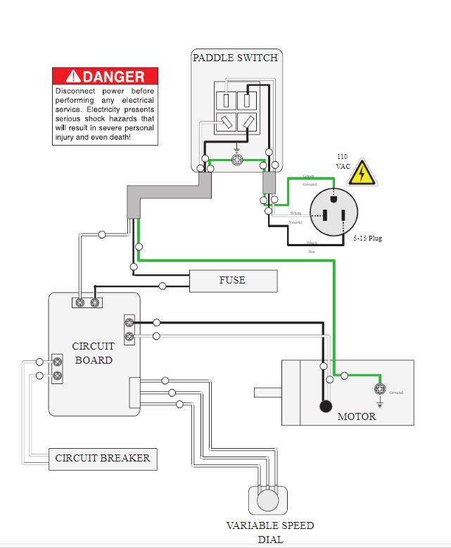

I was looking at a schematic for a SHOP FOX W1704 online and it looks like there is an external fuse which I assume is the one that you referred to. It also shows a remotely mounted circuit breaker that is wired into the control board.
I suppose the paddle switch could fail, not very likely though.
If the Fuse is good and the circuit breaker is not tripped, and the motor didn't smoke or anything, it is probably a component on the control board itself.

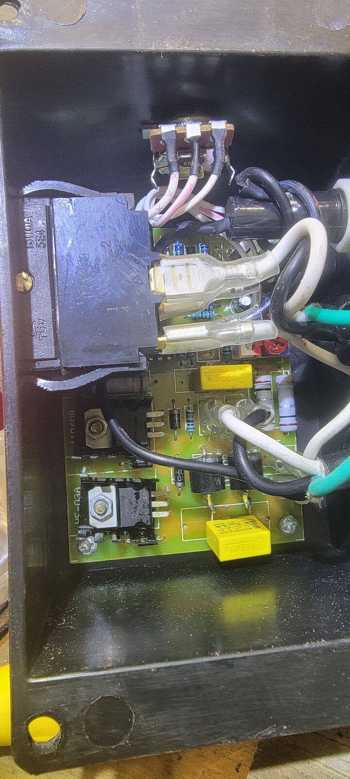

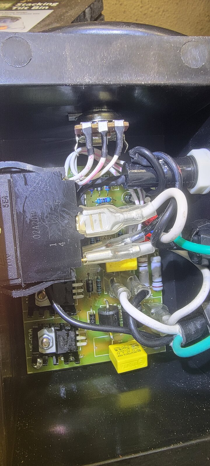

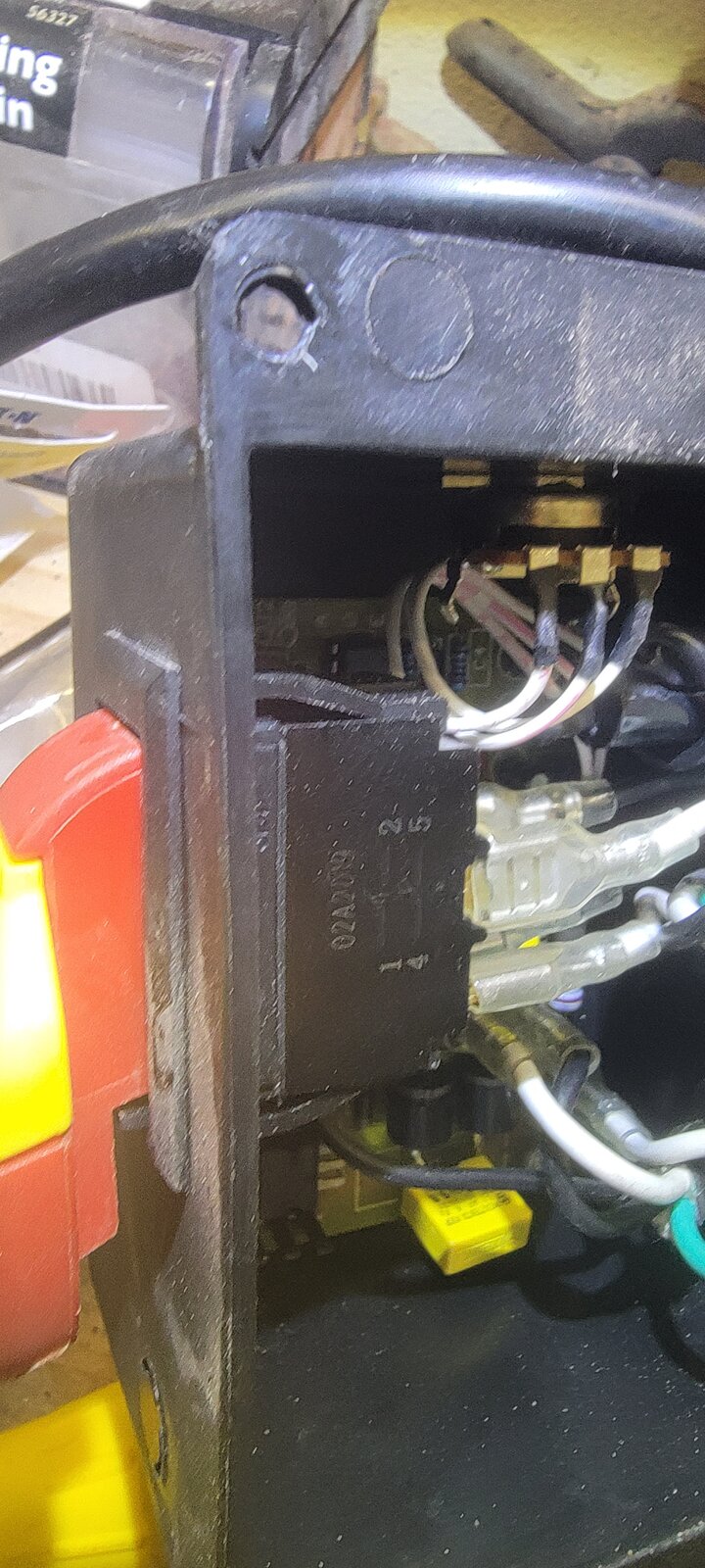

Why me? Lol... y'all have been such a great help and I truly appreciate it. Well here are some pics of the inside of the power box.

How old is this lathe? The instruction book posted on the Grizzly site do not show a circuit breaker in any of the pictures, and there is no reference a circuit breaker on the electrical diagram, but it is clearly marked as applying to machines made after 1/20. Dave posted a circuit diagram that shows a circuit breaker, and I also found an earlier (2013) version of the instructions on line that does show a breaker in the circuit diagram. The current instructions do mention a 'machine circuit breaker' as something to be checked if it isn't working properly. But none of the pictures show a reset button, and Lee reports that he can't find one,. None of the parts lists I've seen mention a circuit breaker as a stand-alone replaceable part, but it could be something incorporated onto the circuit board.
My first lathe was a Shop Fox 1704 that I purchased in 2011, and I found that the instructions were erroneous in several notable ways - the most obvious being that the specification published in the instructions for the spindle threading were totally wrong. That error was corrected in the 2013 version of the instructions, but the point is that my experience with Shop Fox lathes is that their instruction books aren't always reliable sources of information. I sold that lathe many years ago and no longer have any of the documentation that came with it, but I do vaguely recall a reset button.
As to what is the problem - the most obvious, and most easily corrected issue, is worn brushes, and the pictures Lee posted surely show that one of them is badly worn. But there could also be a problem on the circuit board, and unless you are an electronics wizard, the best solution to that would be to replace the entire control box.

No he was referring to a so called circuit breaker within that circuit board diagram that was shown. If you look it says circuit breaker. Not sure what that would be especially when there is a power fuse already.
