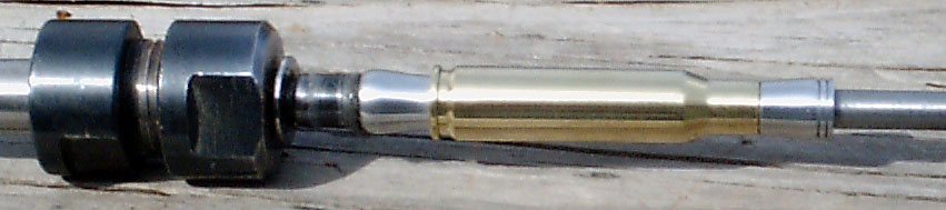

So as to not totally hi-jack this thread here is a brief explanation (with pic) of how I polish casings.
1. After drilling the casing, I mount it on the mandrel with bushings I have turnd just for this purpose. Mine are made out of aluminum but can be made from other material. PVC would be good in this application as it is durable, easy to machine, and no need to be concerned about CA. See pic.
2. If the casing has deep scratches I begin with 600 grit wet paper and sand wet 600, 1000, and 1500 around 1600-1800 rpm. Then I switch to Abralon, sanding wet with 2000 then 4000. Go to # 3.
2a. If the casing has fine or little scratching, I use #000 or #0000 steel wool along with Brasso with the lathe running about 1600-1800 rpm. I recommend rubber gloves as things can turn black rather quicky.
3. If the casing is to be powder coated: I then clean them thoroughly with acetone or naptha being sure to not touch them with bare hands or dirty gloves. A quick swipe with a used dryer sheet helps to keep them from attracting dust till they are coated.
If the casing is to remain "raw" I finish out the polishing with a machine glaze compound then a finishing compond followed up with a coat of wax and good buff with a polishing cloth.
This all sounds like a lot of work and can be until you get your routine down. I can polish from start to finish in less than 5 minutes, 3 if I don't goof off!!! (But I cheat by doing two on a mandrel!!)
