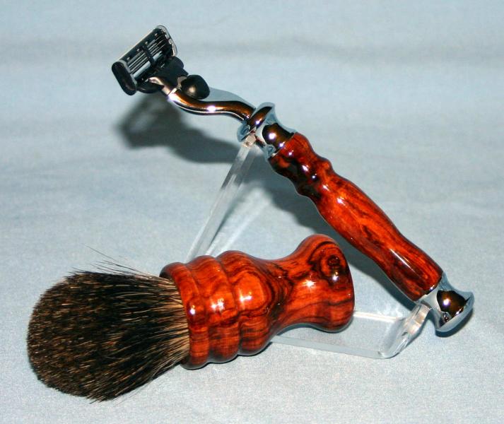

First razor kits I have turned. I like this kit. Brushes are Badger hair knots.
Honduran Rose Wood
Osage - This color of this brush reminds me of the yellow backelite shaving brush my great grandfather had.
Brushes and Razors finished with CA, MM to 12000 and Plastix.
Thanks for looking.
Comments welcome.

Nice looking shaving sets. Where did you get the 7mm tubes for that? I only have tubes for slimline pens and they are a 1/4" or so short. I was planning on cutting the bolt a little and have handles a little short. Not my preferred method. Also got stalled because I lost my mandrels for turning the handle (bottle stopper mandrels). Had two can't find either.

I know you can get all the tubes in the long lengths (about 30cm) from PSI (pen state industries) I know I can get mine here but that wont help you.

The razor kit from Bear Tooth Woods comes with the 7mm tube provided.
I used a bottle stopper mandrel to turn the brush handles.
