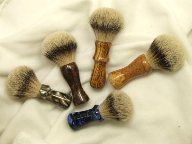

Finally, instead of selling these heads, I got around to making some tonight :) A couple of Brea acrylics, some of the darkest masur birch I ever had, bocote and brown mellee. Heads are 24mm & over stuffed 28mm. Thanks for looking.

Great job on those! Where did you find the larger acrylic blanks? Are your others stabilized? I'm tryig to decide on a good finish for my woods.
PenWorks
Aug 18, 2004
5,186
Scottsdale, AZ
Jim, they are the bottle stopper blanks from BB. I think they are 1 1/2 x 2 1/2
The maasur birch was stabilized. All three have a CA finish.

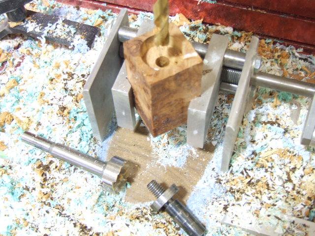

I use a foster or spade bit that comes closest to the plug size of the head, I bore this hole about 3/8 deep. This leaves me a little room for counter sinking the head and squaring the blank end if I have to. But I ussually have the blank allready squared. Still leaving the blank in the vise and centered, I then drill a hole for the threaded mandrel, I use a Q or R bit. This is undersized hole, as I tap the hole with a 3/8 x 16 tap. This gives me a secure hold on the mandrell without haveing to worry about stripping the threads.

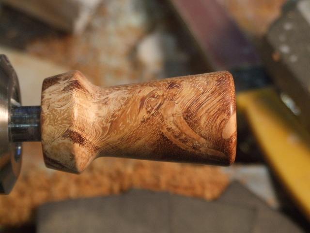

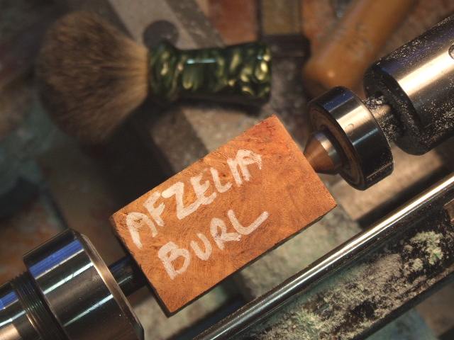

Turn to your desired shape and finish. This is the sample I recieved from Jeff of a stabilized afzalia burl, just sanded and ready for CA finish.
