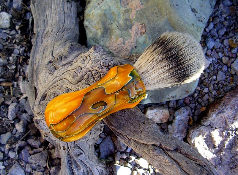

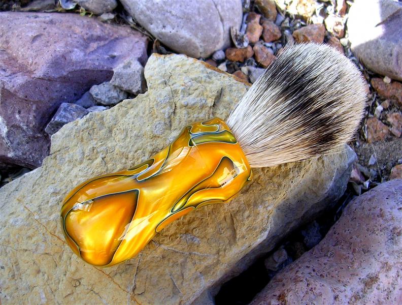

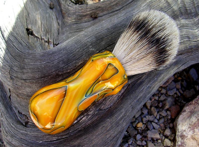

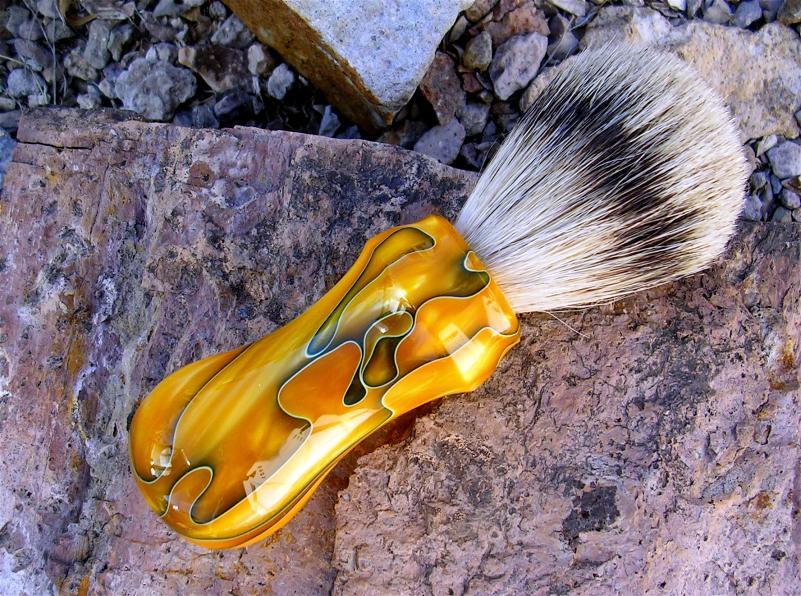

I just finished this Silvertip Badger shaving brush in Tuscan Sun Acrylic.
I tried a few different backgrounds when taking the photos.

I can understand the background being a bit distracting. For me it is just easier walking out the front door and snapping a picture than setting up a light tent and such. I eventually get around to that.

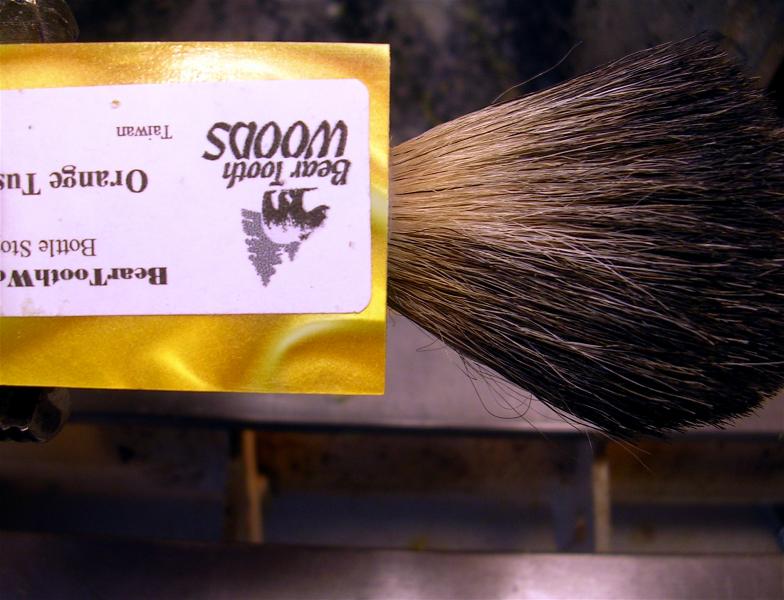

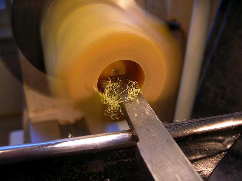

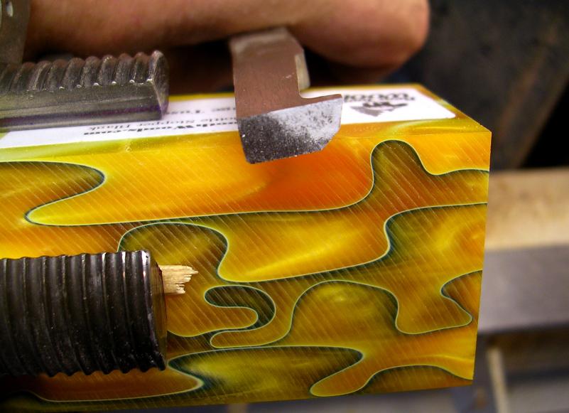

The knot diameter is 3/4. I fit the knot to the hole with a special ground scraper for a nice fit.
Loft?-- I just installed the knot as it came so I'll have to research the term *g*

Loft is the height of the hair from the tips to top of the handle.Example:45mm 50mm 55m.Setting the loft at different heights makes the brush behave in different ways.

Thanks for clearing up my ignorance.

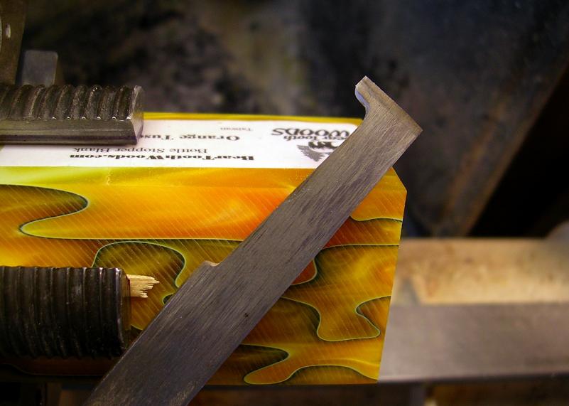

The loft on this knot is 58-60 mm. The knot diameter is 20mm.
I found a 3/4 drill bit worked well so i could get a snug fit by using the tool in the attached pictures. It is very much like a relief tool used in hand chasing internal threads.

Nice setup,tool looks handy.Do you use shaving brushes?I do.I have using them for years.For all around performance of that size and grade of knot I suggest you set the loft between46-48mm.Not that you asked, I just felt like trying to be helpfull

LOVE IT!
.....and i like the driftwood background personally, even though i would typically say they are distracting, for some reason the picture on the far left looks really good with it!
