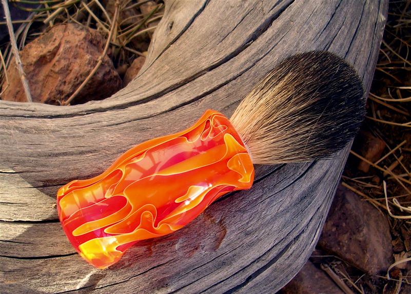

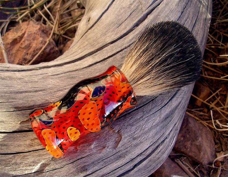

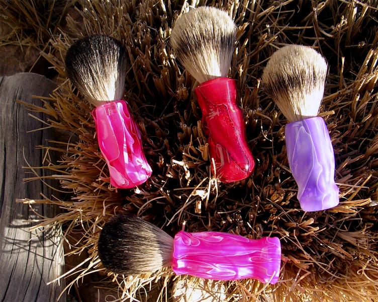

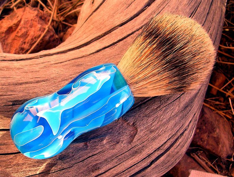

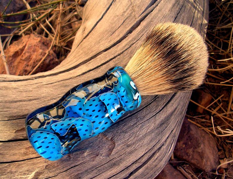

These are part of the 29 brush project I am doing. I just finished it up today.
I still have to buff and polish the last eleven handles so I can ship them out.
The knots are just dry fit in the handles for photos.
I used a jamb chuck to drive the blanks on these type of blanks since a tapped hole for a threaded mandrel would show through the handle.
All in all, I was pretty pleased with the way everything worked out.
The horizontal one in the group shot is a translucent pink.
Not much time to snap photos so they aren't that great. I was anxious to take some and get a break for working on the handles:)

Blanks in photos from left to right:
1- Bottle Stopper Double Blank - Blue Topaz Water
2- Bottle Stopper Double Blank - Blue Topaz Water Mesh
3- Bottle Stopper Double Blank - Citrine Water
4- Bottle Stopper Double Blank - Citrine Water Mesh
Group Photo- Top L to R -1- Bottle Stopper Double Blank - Luscious ,2- Bottle Stopper Double Blank - Lava Flows,3-Bottle Stopper Double Blank - Lilac Pearl
Bottom one- Bottle Stopper Double Blank - Rose Water
All blanks are from BearToothWoods
