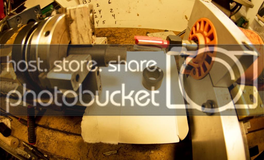

machining
Thanks for all of the advice! :) I need to consider it all and reassess my situation. I'm flying out to Cali for a bit under a week, so I'll be back with energy!
George, I was just using a couple acrylic blanks I had before. I wanted to get to the bottom of that before trying out the exotics! I know they'll turn real beauties!
Depending on what style of lathe you have.
