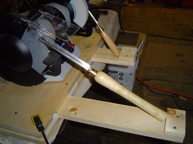

I was building some shelves for a bedroom closet over the weekend and had a few pieces left over, just as I was about to throw them into the pile, I put them down in front of the grinder, and poof, brilliant idea number #345. I could use them for a sharpening jig.

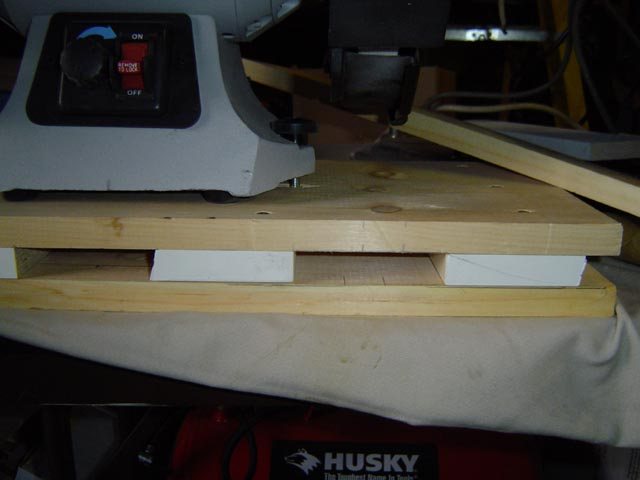

I used a couple of 1x 12 and a few 1x3 boards, a bunch of exterior drywall screws and a couple of bolts to secure the grinder to the wood.

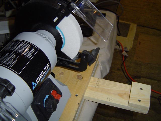

All I did was make a sandwich with the 1x12 putting the 1x3 in between. Then screwed it all together, done. The only thing I made sure of was that the sliding 1x3 were centered under the grinding wheel, all the rest just fell into place.
Because the sliding boards stick out the back I put a clamp there to keep it from sliding while sharpening. As the tool becomes shorter I’ll just adjust the clamp to give me the same angle.
I have been sharpening free hand. When I got my tools I marked the length and angle degree of each tool on handle. Figuring if I really messed up I got get it back to the original measurements.
To set the initial marks on the slider, I just put the angle flat on the stone and made a reference mark to go back to.
This worked like a champ. In fact I sharpened everything twice just because it was so easy and fast. I know …I know……..
a block to rest the handle on, and a mark for each tool

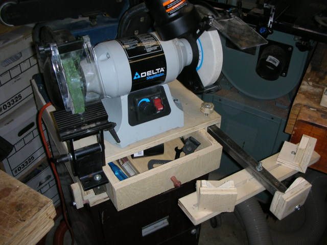

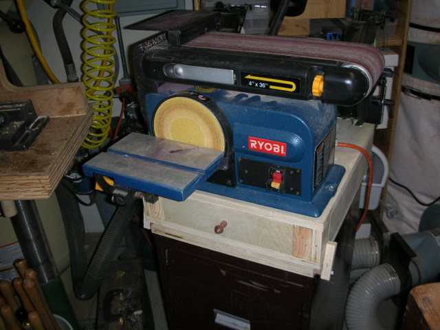

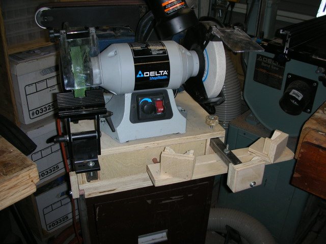

Well, this thread and my recent purchase of a new grinder inspired me to put together my own version. I've got a pretty small shop, and my rule is that pretty much everything in it needs to be on wheels, and should ideally do double duty.
I was using an old metal file cabinet to store drill press items, and would use the top of it to put either my belt sander on it, or the grinder. I decided to kill two birds with one stone and put a lazy suzy bearing on top of the cabinet, and made my own version of this jig, with a little drawer in the middle to store accessories, like wheel dressers, etc...
I used a 1 inch steel tube I had around for the arm and created a weird wing thing for grinding skews. I used a little short section to mount my veritas tool rest.
Now if I can just keep myself from making jigs for a few days, maybe I can actually turn some pens!
