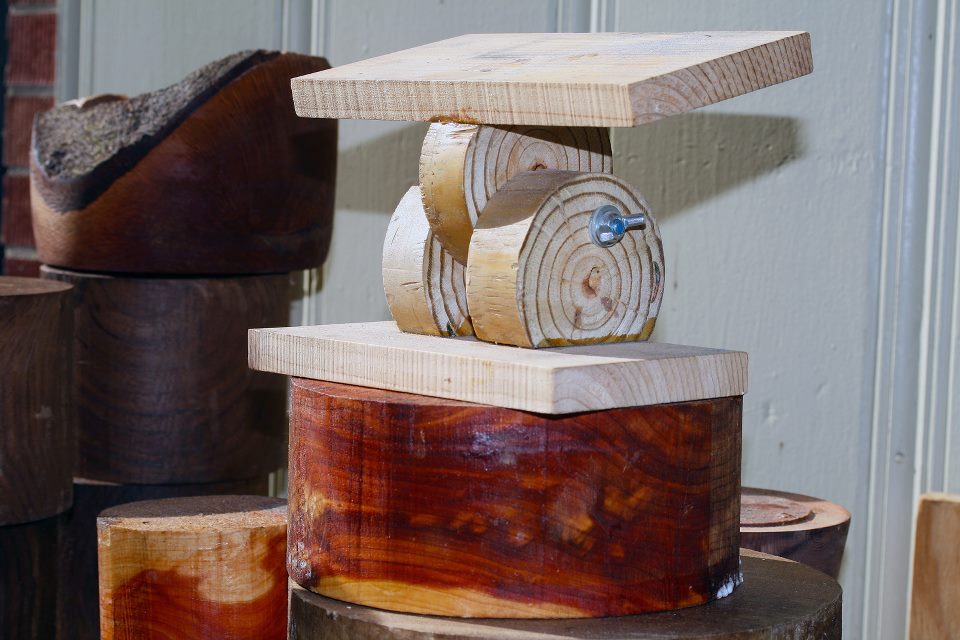

One does not need expensive equipment to ask http://www.penturners.org/forum/f14/sharp-japanese-waterstones-111876/
A simple setup with a bench grinder can net you something like this.
attachment.php
The key to sharpening is nothing more than consistency. To get consistent results there are a good number of devices out there that can help with that but the real issue boils down to form. That is body position, placement of your feet, shoulders, hands and the like. Some equipment even tries to take those factors out of the equasion but the more they try to take things out the more $$ the solution becomes.
