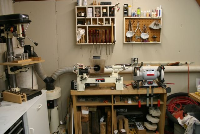

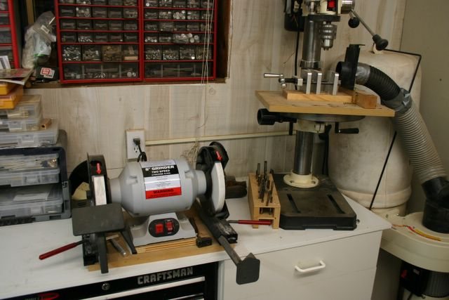

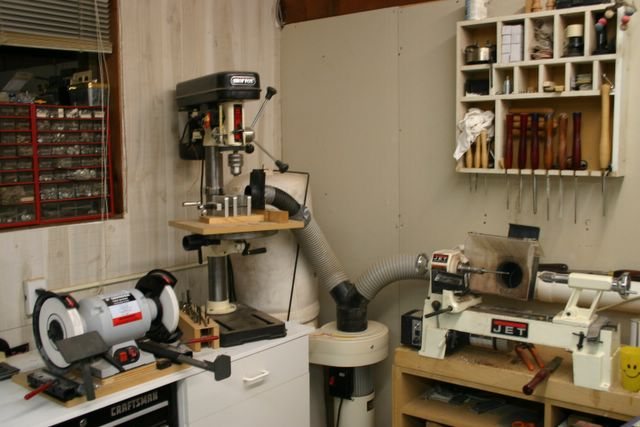

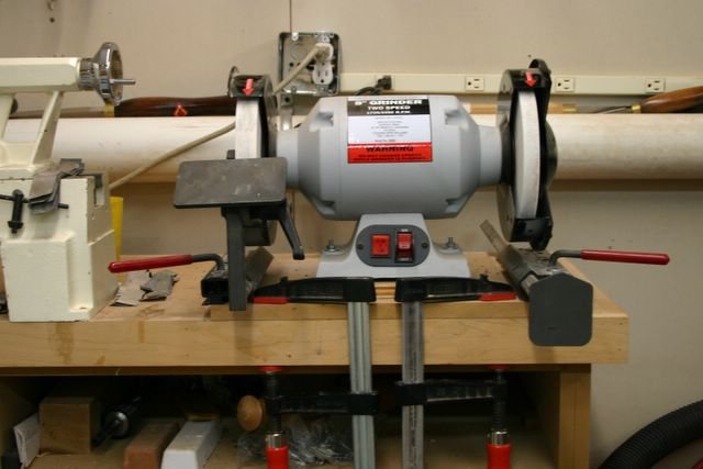

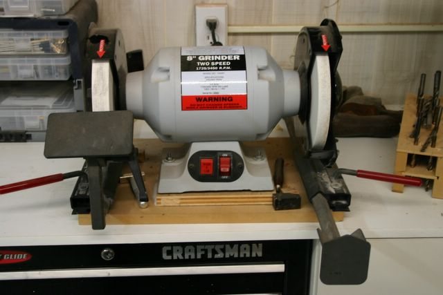

Strange enough a person in the shops section had the same kind of question [:)] so I will re post my pictures here, hope it helps, Dave

I just saw that other thread - the one in "shops" - thanks for the repost.
How is your grinder etc secured to the table? or isn't it?

I put clamps between the grinder and the tool rest posts when I move it over to the lathe table. Honestly though, I have been lazy as of late and leaving it where it is with my shoulder being all banged up but after reading the other thread I am reconsidering that attitude[:I]. Thanks for the compliment[:)].
