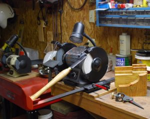

The chisels I am sharpening are HSS BB penturning set and HF full size set. The sharpening setup is a HF 6" dry / 8" wet bench grinder. I hardly use the wet wheel as it has not tool platform. The 6" wheel is, presumably the one that came with the grinder (inherited from my father). I have basically sharpened the BB penturners roughing gouge down to a nub in the past two years. I'm sure the wheel is much too aggressive. The tool platform on the grinder is pathetic and I don't get a consistent and sharp bevel on my tools. Really, the fun has gone out of turning now, because we are constantly anticipating losing blanks to blowouts. I need to remedy the situation.
My plan is to definitely buy the Oneway Wolverine Sharpening System (v-holder and platform).
My questions are:
1) Can I stay with the HF grinder and upgrade the wheel to a Norton 3x 80 grit?
2) If I absolutely have to, I am thinking of buying the Delta 23-199 variable speed 8" grinder. Any experience with this?
3) I would change to Norton wheels for the 8" grinder. Are 80 and 120 grit appropriate?
I really need to learn to sharpen and get a proper setup as we are both getting frustrated. I appreciate any input.
Since I got Wolverine system this past winter, it's on my "recommended" list, as is a variable speed 8" grinder and 100-120 grit wheel so you can slow the speed down and stop burning up so much metal when sharpening.
For comparison, I've got a Porter Cable VS grinder, probably about the same as the Delta I imagine. I remove very little material from one sharpening to the next, especially if I'm not switching around and sharpening different tools in between. Here's mine set up for keeping the skew sharp, along with the almost-retired 6" one-speed in the background:
