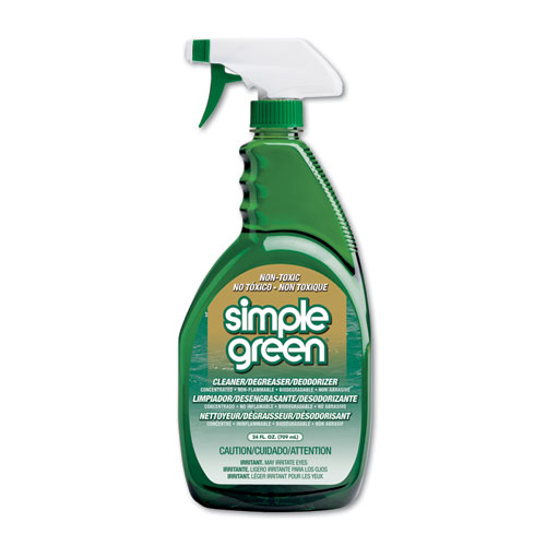

I bought this and would use it if I could clean my cutters.
I bought the Trend Cleaner and even soaking the cutters overnight does not soften the "debris" on the cutters enough to sharpen them without clogging the diamond stone.
Anyone have any ideas on this?
You could try acetone and soak them.
This is what I use on my planer blades. Soak them overnight and ready to wipe clean in the morning.
