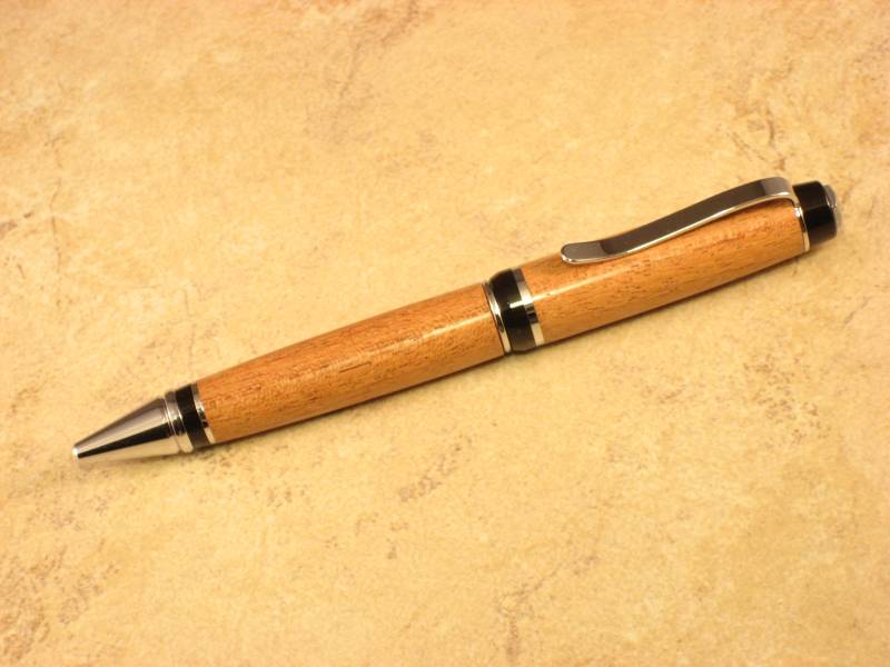

Oh yeah, also please comment on the photo or whatever else you feel like saying.

Oh, right...i know that it is slightly out of focus, especially at the nib (im still trying to figure out the proper setup for my camera) but the colors are true. Additionally, in a previous post somewhere around here i mentioned that i wanted to go with a reflective black background and although i still think its more classy that anything else ive seen, problems with contrast on darker objects and a comment from another member about complaints he's had, ive sort of turned away from that. I want photos like you would see in jewelry catalogs and basically, have not been able to achieve anything close so far, so any suggestions would be helpful.
Thanks for all the help youve given so far.
P.S. I'll be posting more pics as i progress so that you can all critique my amateur work.[V]
