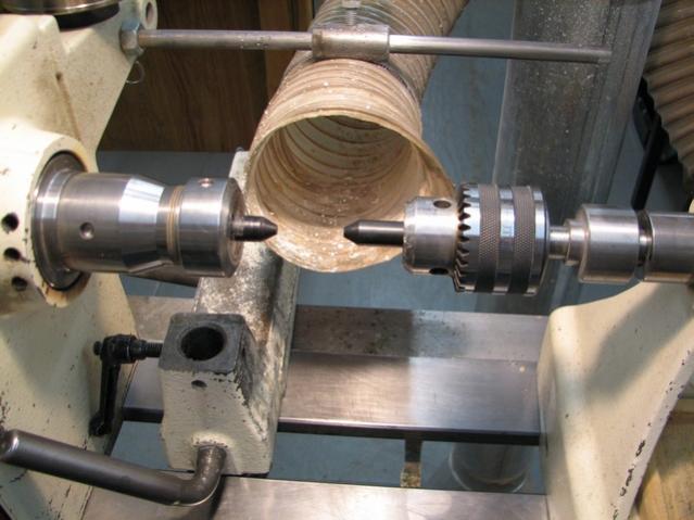

rherrell
Aug 22, 2006
6,336
Pilot Mountain, NC
This is how I cured that problem. Homemade Delrin centers and a revolving tailstock.
