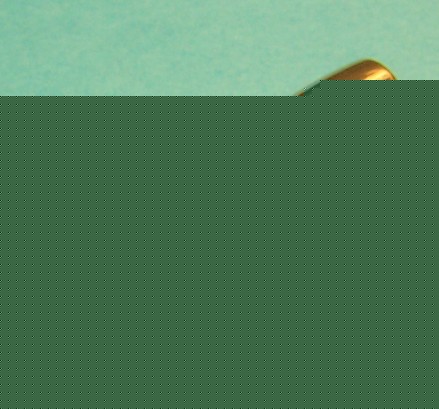

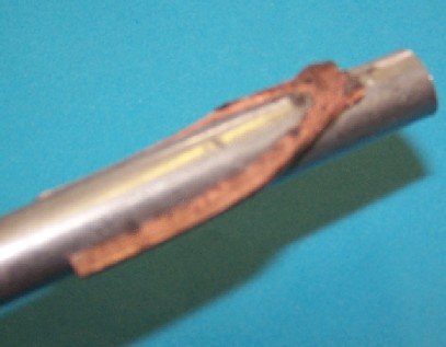

If the copper was segmented at 90deg to the blank (like a cb) then the thickness you are drilling really won't get hot. With such a thin piece sticking out the sides of your blank, I would imagine that as soon as you touch it with a chisel, it would just fold over or snag. If the copper is angled and sticking out the blank, it would snag for sure. Here are two pics ( crappy I know ) that show a slither of copper CA glued into a ali tube. I'm sure you must agree that you could not (safely) turn this with a chisel. The second pic shows how I got it flush and smooth with a file. I filed it reasonably flush first with the lathe off and then with the lathe on.
Before I did any filing, I mounted the rough blank in my PH vise to really hold it together then drilled the length of the copper to fit the tube.
