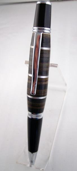

I don't know if this will help, but I used a plain thin strap of aluminum (1/16") from Lowes to make the inserts in this segmented pen. Admittedly, I was using leather instead of wood, but I had a challenge to keep the leather stabilized enough to progress down the turning. As long as I kept re-stabilizing the barrel, I didn't have much problem carving both the leather and the aluminum. I was using my basic HSS chisels, but had to keep re-honing them often. Based on what the strap felt like cutting and shaping it, I would guess it to be about T3 temper.
