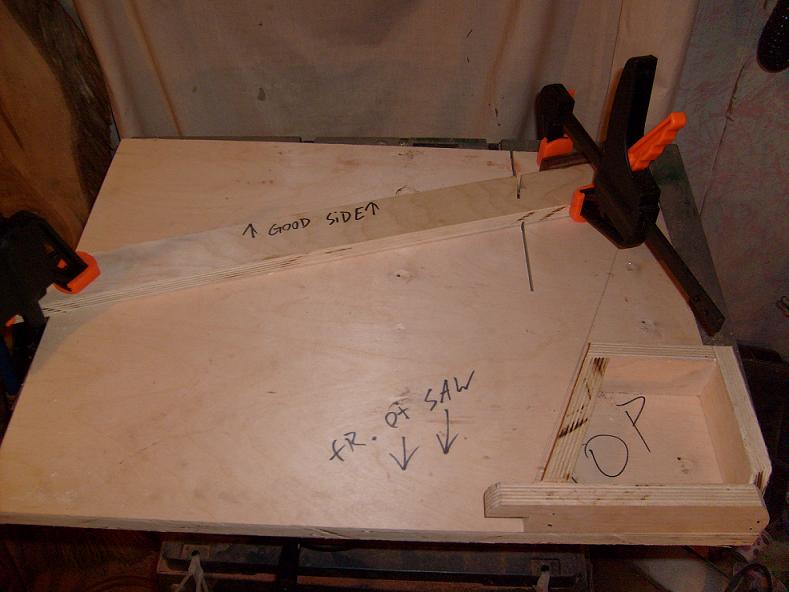

I found a really simple design for a frame miter sled for the tablesaw.
http://www.turnedwood.com/framesled.html
Here is a picture of my first version.
So far, I have only used mine to make one test ring, but it came out pretty darn close for a first try at segmenting with a brand new sled, and a cheapo tool from Harbor Freight. I will soon venture deep into the realm of segmented work. I plan to find out the current record for most segments in a pen, and DOUBLE IT! I have this dream of a single pen blank made from 1,000 segs.

I am in the middle of gluing up a segmented blank that will approach the 1000 different pieces. Lots of sticky fingers...LOL.....
If you let me know what you are looking to do, I will be happy to talk to you about your design and potentially ways to accomplish the design you are looking for.
Good luck, and lets see some pictures!

Dennis & Rojo - I like the way you two think!
I've always been inspired by Eagles work and want to continue pushing myself in the way he did. I've just rebuilt my table saw sled to allow for smaller segments (4 time smaller than previously) and should be turning my first piece today that includes some.
