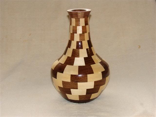

A couple days ago I got a notice that my 30 day free trial on the Segmented Project Planner was running out so I bit the bullet and ordered it and now I am quite glad I did .
Here is the first project I made with it since ordering it and getting the installation right to my computer a couple days ago.
I was quite upset that the top 4 rings are a lighter color than the rest because all the walnut wood was out of the same board but some was closer to sapwood.
I didn't notice it until I applied the finish and was pondering whether to part the top 4 rings off and re-do them but decided to leave it as is.

It is not sale-able at all due to the color mismatch in the upper rings but then I had no intention of trying to sell it.
Wife claimed it right away.
It is 10" tall and 7" wide at the widest point. It doesn't look that big sitting on the stereo speaker beside our 50" TV but that is where wife found a spot for it after putting some artificial flowers in it.

Very nice work, I have done some segmenting, but never one as large as
your vase. I also had problems with the color changing in the same board.
How many pieces and what is the contrasting wood? Maple/Ash?
Thanks for sharing.

Curiosity question from someone who has never done one of these, Is the inside of vase smooth like to outside or is it rough segment?
Thanks for sharing.
RR
There is a solid base and twelve segmented rings.
12 segments per ring so that makes 144 segments plus the base.
It is hard maple and walnut.
Color changes like that are sometimes difficult to notice when cutting the pieces but they surely show up after finishing . :eek: If it had been a custom order for someone I would definitely have parted off the top four rings and replaced them with same color as the ones below.
The inside is exactly the same smoothness as the outside for the simple reason I glued up the first four rings and turned and sanded inside right to the bottom , then added the next four and turned and sanded them and repeated the process with the last four . No problem reaching in that far on each set of rings with tools and sandpaper down to 400 grit.
It doesn't really matter all that much for a narrow neck hollow body to be rough inside and I know some leave them rough . I don't because I know someone, sometime , will always want to shine a flashlight in there to have a look and when they see it as smooth as the outside it puzzles them to no end how tools could reach way in there to do that and how in the world it could be sanded in there as well when reaching through that narrow neck . :rotfl:

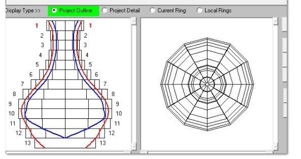

Even though I got the program shown at this link
Segmented Turning.com - Home of the Segmented Project Planner
I did not design that vase myself . It was a new and recent addition to a number of ready made designs that come with the program and that one sort of appealed to me so I decided to give it a try.
When on the 30 day free trial a person is only allowed to print out up to the first 5 rings of any project either in the site or self made.
That one had 13 rings so I was able to print it out as soon as I bought the program.
As well as having it delivered right to my computer , I also paid a few extra dollars for a hard copy in the form of a CD and it is presently in the mail.
I called Bill Kandler about a few things I was not sure of and he is very helpful and great to correspond with.
This is how the plan looked when I started making the vase.
Now I will be spending some time to use the features of the program to make up some designs of my own.

That vase has outstanding form and you are a fussy butt worrying about color of the wood at top of vase. Looking at photo appears other color variations lower down too!
If making furniture can always dye boards to get a uniform color. As wood turners we embrace variations in color, grain, figure the more the better. As a segment turner, dying a board to get a uniform color just about impossible.
So we disagree, principles of design (color & contrast) no big deal. Thanks for sharing review on software and looking forward to seeing your next project.
