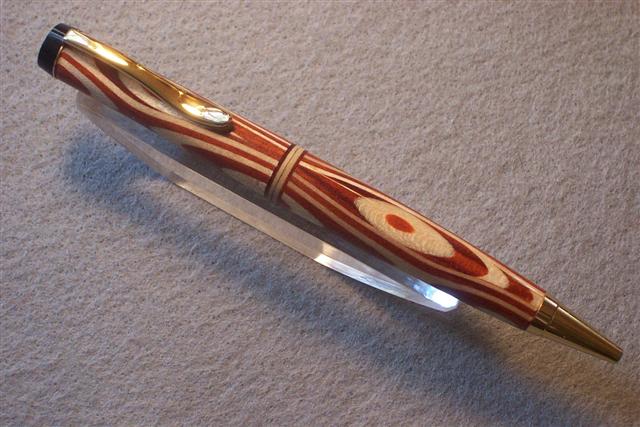

I started making pens over 2 years ago.My third pen was a segmented spiral.Though I had a some flat work experience, to me glue was the "insurance", not an integral part of the project.In gluing up blanks for pens,the choice of adhesive becomes more of a factor in the finished piece.At first I used CA because it was quick after a while I discovered there were times when diffrent adhesives had their advantages.
My first "complicated lamination was the "sexy pen"
<br />There are 29 pieces of wood in the blank ,eight glue up sessions, 4 cutting sessions and if I stay on schedule 3 days to make.(Just for the blank turning /finishing not included) to get the effect I wanted.Because of the method I used to make this blank I chose to use yellow glue, I have made it with CA and there are no adverse effects, but if the ca set before it gets clamped up the blank is toast.

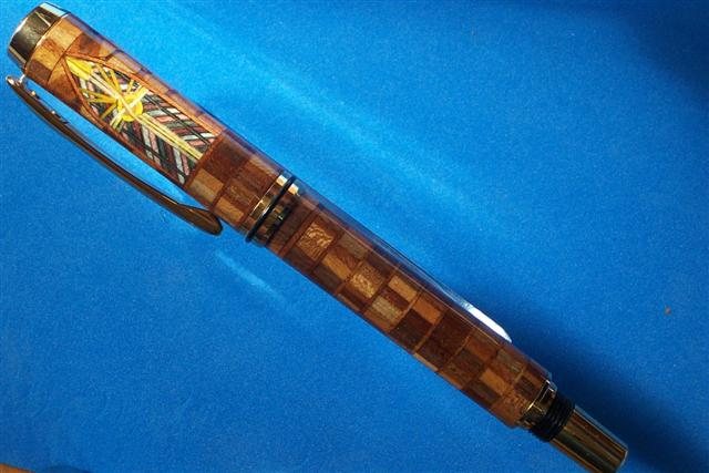

"Stirred Not shaken" was glued up using a bad piece of flaming box elder as a base(try and find it) with veneers of bloodwood, puple heaqrt and yellow heart.As I turned it ther was a feeling I was turning a stabilized blank. Had I used yellow glue for this one I would still be gluing it.
In One for Giving(my first Pentarsia pen) because of the size of the pieces, the number of pieces and the intricacy of the design I don't think yellow glue would have worked.

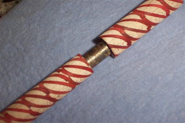

Do you think for one minute I used any clamps in the pen with the cross in the window?
BTW here's another one I didn't mention
Lite brite, how would you clamp that?
It was done with CA and a form.
The tutorial can be found on the TPS site.
This is actually the second one I made and no clamps were used in the making of this pen

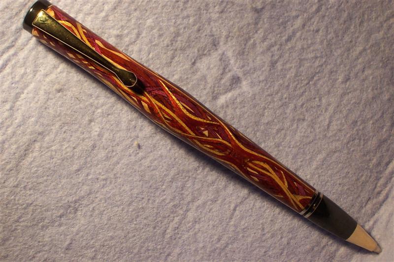

ANgles? you want angles?
Here's angles,CA and again no clamps
This was called the 120 cut spiral.
