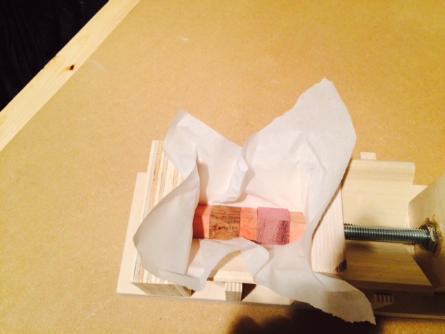

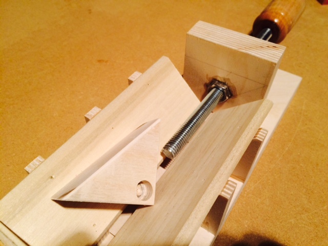

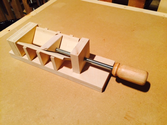

I am interested in trying to turn some segmented pen blanks, but first need to make them. Somewhere on this forum I saw a post that included the idea of a jig that used a press screw and decided to try to build something myself out of stuff around the shop. (sorry, I can not remember who the post was done by)
The majority of the project is made from 1/2 baltic birch. I used that to create the cradle spines and then added some hobby popular i had left over from one of my kids projects for the sides. I had a short piece of 1/2" threaded rod and decided to turn a handle from some oak i had and then used epoxy to glue the handle to the threaded rod. I also expoxied a 1/2" nut to put the threaded rod though as i did not think "wooden threads" would give me the tension i think i need to press the glue out and make a seamless blank. I also added a "push block" and drilled a 1/2 hole to guide the rod and keep the tension.
If you look closely, I left a small gap at the bottom of the v-cradle so that glue has a place to escape instead of soaking into the wood - leaving me a mess when i try to turn. I am also planning on using either parchment paper or alluminum foil to minimize clean up. I will just need to remember to press a little extra into the bottom slot so the glue has a place to pool.
Oh course, all of this is speculation, as I have yet to try it - just wanted to share my idea. Will let you all know how it works.

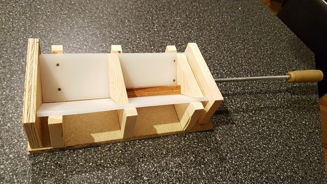

Thank you Chris for this excellent jig design.
I just made mine and used HDPE from an Ikea cutting board ($1.49). The base measures 13" x 7.5". The height measures 3.5". Certainly, if only being used for pen blanks, this jig can be made a couple of inches shorter.
This can clamp 2 blanks at a time. The previous post that mentioned centralizing the threaded rod made sense to me, but now that I've made it, I see that it's not correct. The blank sits at the bottom of the triangular clamping pieces and that's where the pressure needs to be. Chris has it right. I may re-position mine. I used a 12" long, 3/8" diameter threaded rod (about $3.50) and a matching threaded insert from Ace Hardware ($.79) hammered and epoxied into the front block. I haven't done it yet, but the threaded rod could be cut down a few inches. To really make this an efficient jig, an even better design would be to use one of those sliding, quick release, ratcheting bar clamps, but I'll leave that to those who have more time than I do.
I hope this helps someone else. I'm thoroughly enjoying the segmenting journey.

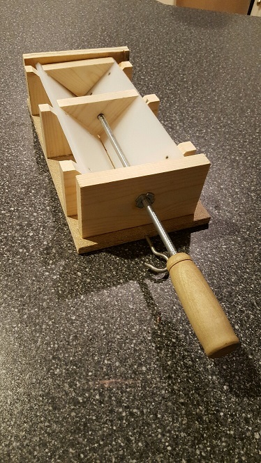

Mrbbcrafting
Mar 16, 2017
9
Virginia Beach VA
I made one very similar to this. I will post a picture when I get home, mines a little big and blocky because I used wood and hpde together for side rails and front and back. What I did for the push rod - I put through a threaded hole, threaded the rod, on the end of rod I took a piece of harbor freight clamp ( the tip that moves around ) and cut that off and CA it to end of the threaded rod, that way when you push the triangle block at end, the clamp piece will meet it where you want it to and keep pushing it forward. Of course I wouldn't clamp this down with 1000 pounds of pressure, but for doing a segment glue up works fine. I have made 2 segments with it and works wonders.
