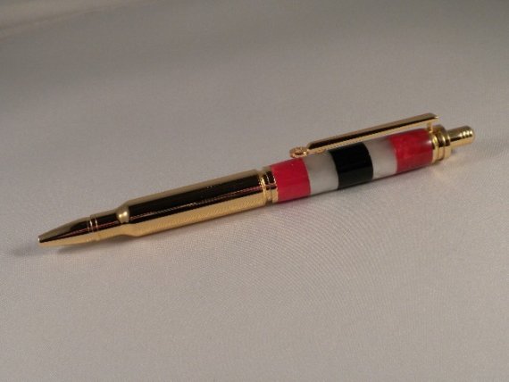

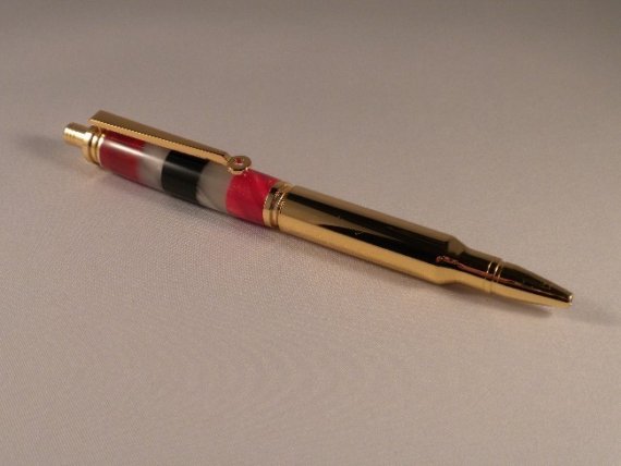

Here's one I made from scraps of acrylic I had left over. Just CA'd them together drilled and turned as normal.

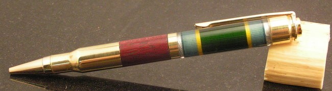

Is this something like what you had in mind? I had to dig way back for this one, it's from a while ago. Anyway, nowdays I would use a bullet for the nib and put the clip under the casing base on top instead of just sticking it on top, but the basic concept still holds. I still have this pen and still use it regularly.
BTW, that's a USAF expert marksman ribbon on top, over a section of purpleheart.

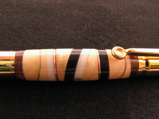

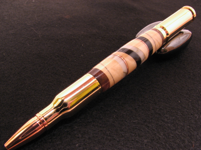

This is one i did cuting using 11.5 degrees some coppper and some aluminum. Just glued it all together and turned.
