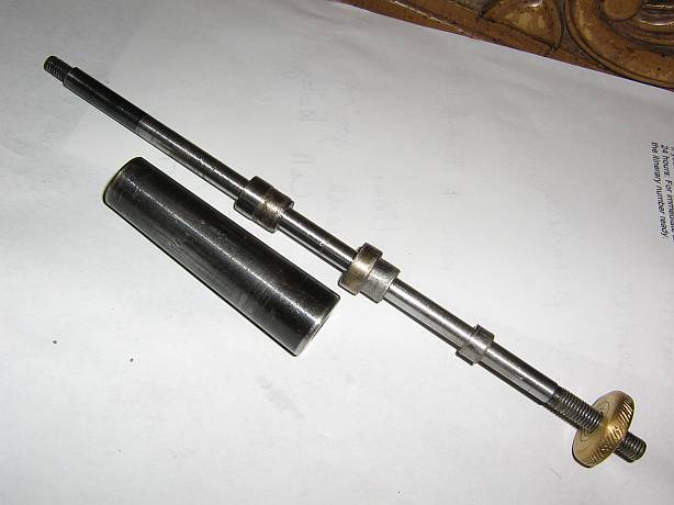

underdog
Sep 11, 2006
604
Watkinsville, Georgia
So here's a picture of the mandrel with bushings:
<br />
Pen Mandrel, #2MT, bent mandrel shaft, worn bushings, Size .246" Dia, .8mm tpi on MT end, .9mm tpi on knurled nut end. I'm guessing the bushings are probably for slimline set.
JimGo
Jan 24, 2005
6,498
North Wales, PA
Russ's site has a great discussion about how to straighten the mandrel, but you can replace that with a brand new one, including the MT adapter, for about $15 at Woodcraft, or you can simply get the new madrel for about $5 (may be less) at Woodcraft (or order online if you want). That set-up is exactly what Cav was telling you to stick with 'till you can afford/justify buying the Beall.
Those bushings don't look like slimline bushings to me, except maybe the one closes to the knurled nut (the brass nut). I haven't done any of them, but they look like the kind of bushings you'd use on a 7mm Euro, but that's just a SWA guess.
