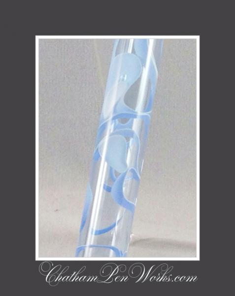

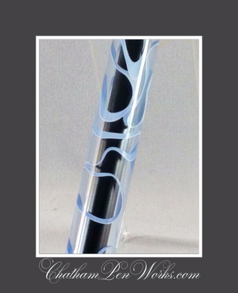

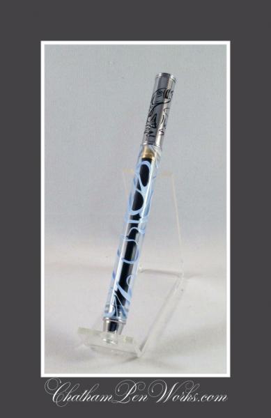

I got some of these from CSUSA a while ago, knowing I had some figuring to do to get the drilled hole looking anything close to presentable. I think I got it. I'm happy with the results. :) Hope you guys like it.

I am working on a pen with a similar blank right now, at the turning stage. The painted interior hole is not quite ready for prime time. What did you do to produce such a nice surface and finish on the interior of the hole?

I finished the intside very much like the outside. I glued a few grades of MM to some thin punches, and chucked them in the lathe. Finised with some polish and some old t shirt wrapped around another punch.
I think the most important step though, was in the drilling. I used a sharp drill, worked slowly, and watered the hole often. This kept the bit from heating up, and melting the blank as it drilled.

Thanks for the feedback for the surface finish of the hole. Is there an insert or did you paint the hole...I really cannot tell. If you painted, can you throw out the details on that too?. My pen is a "Princess" ballpoint, painted on the inside, and that is mostly where my problems exist. It is hard to get a perfect paint job inside there, and the clear blank puts a magnifying glass right on the flaws.

I always wanted to do that but never got started because I figured the hole would always be messed up. You sure prove that wrong, and looks great and thanks for sharing.
