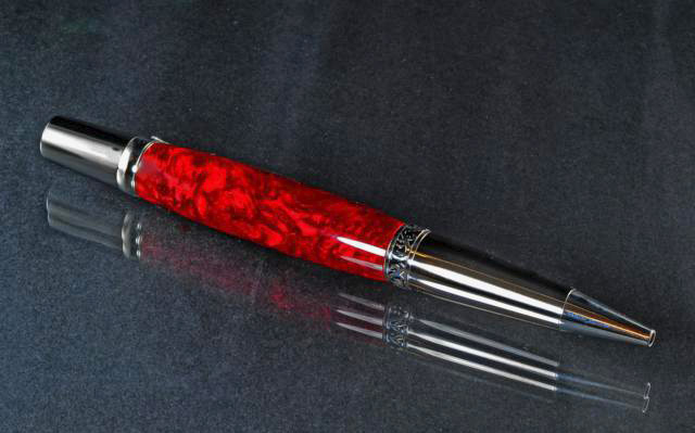

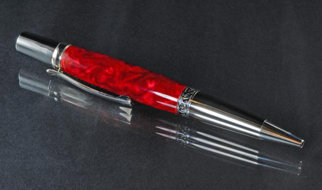

Thanks, Lenny! No black! 1 oz. resin - 8 drops red transparent castin craft pig from Michaels and .10 gram Paradise Majestic Pearl Red. The black comes from the transparency of the blank over a tube treated with Brass Ager, available from Indy~Pen~Dance here in Indy. Cheap stuff, use over and over, and does a great job, like no need to paint!

Lenny, I guarantee once you have used it, you will never pick up a paint brush or airbrush again. If I'm wrong, I've got three or four airbrushes I'd be happy to sell ya!!! :eek:
