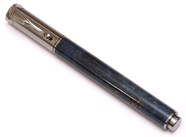

I had been hesitating because CA was so successful for me. But with it being so cold, CA was being a you-know-what.
So I just went for it. The first one I did might have been a fluke, so I did another.
I likeeey. Lots. Way easier than CA. Cheaper too.

Very nice. Is that the plexi melted in acetone?
Yeah. I mixed it during the summer to a warm syrup consistency. But when it got cold I had to add acetone to get it back to that same consistency. Very temp dependent. But it still cures FAST.

Faster than un-accelerated CA at my garage temps... 40* or so. A generous smear on the Zen barrel cured in 2-ish minutes.
I did three of those generous smears, waited 2 minutes between each, then 2 minutes after the last application I hit it with 600 w/d paper. Wet of course.

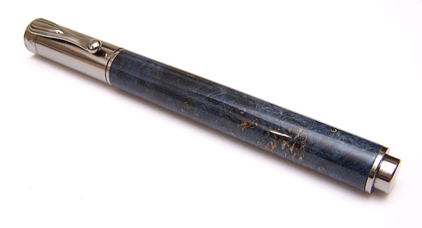

Good looking pen and interesting technique.:):):)
here doesn´t appear to be a deep shine on the pen, but that may be this computer screen.
It's as deep as a CA finish. You can see the sharp line of light in one of the pics. I was trying to capture the figure of the wood, not the shine of the finish when I was photographing it.
