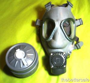

I'm telling you folks, my mask for $14 on ebay saved me! Really. No one has said they've tried it, but I'm telling you, it's not all that cumbersome and you don't get any fumes. Try it. Hey, for $14 you should at least try it before giving up on CA.
