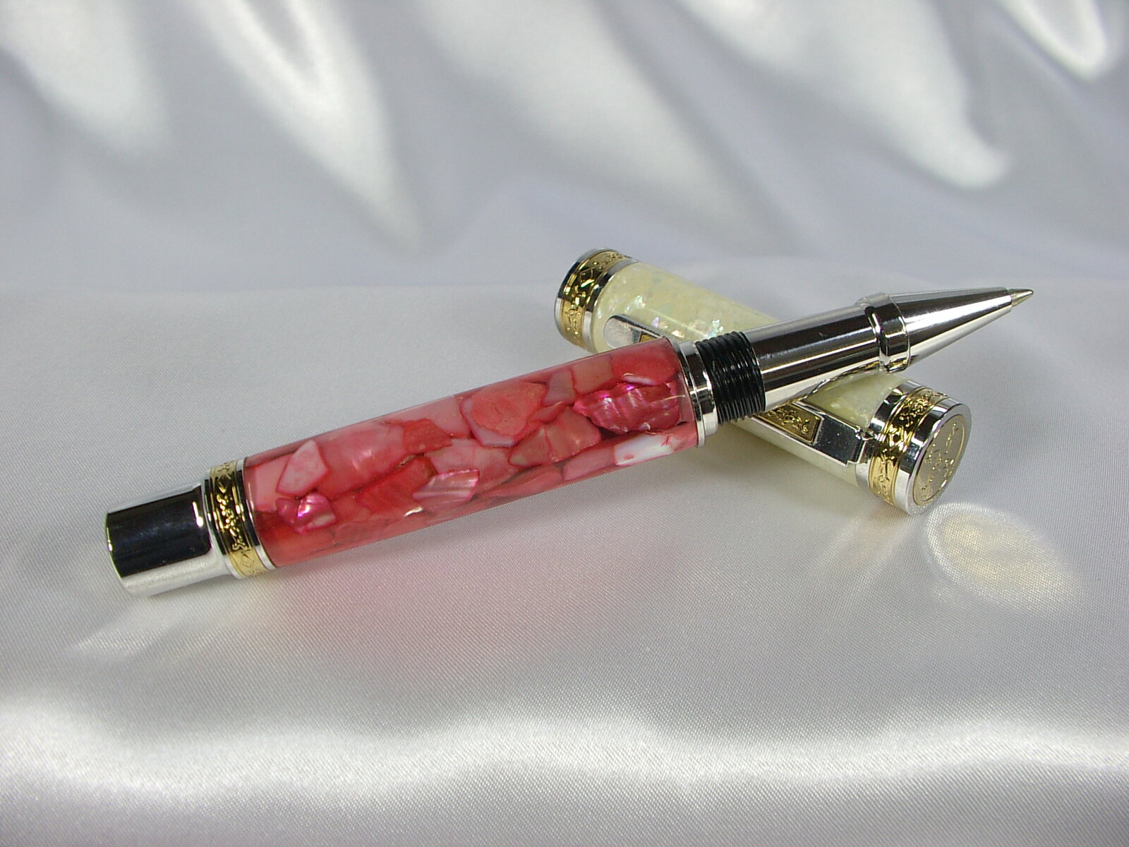

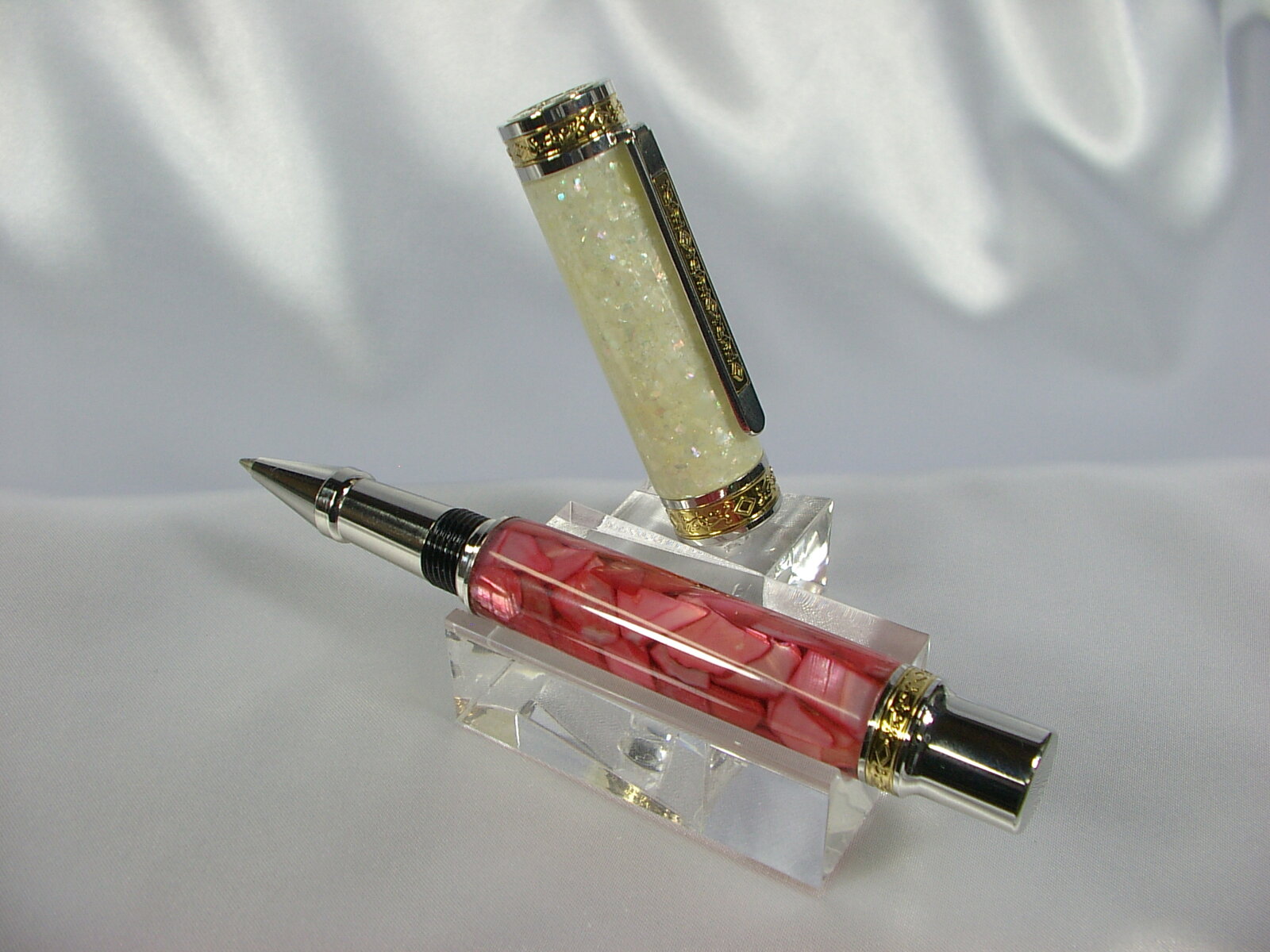

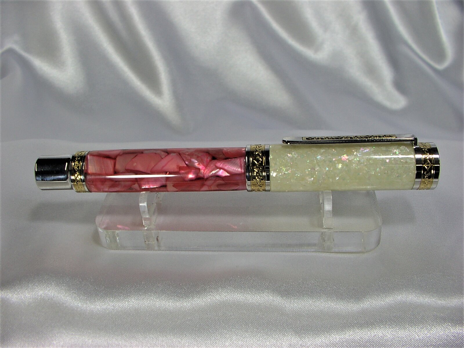

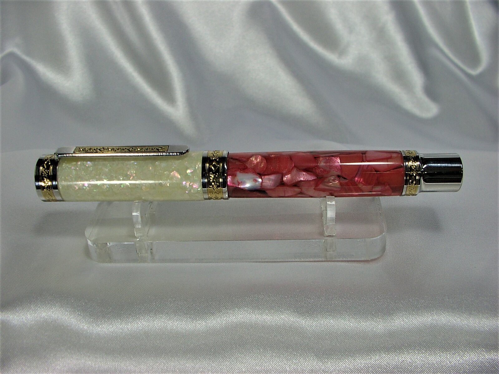

Here is a different pen style I made. It is a Spring Blossom rollerball kit. The blank is made from crushed mother of pearl dust in the cap and the body is made with red seashell pieces. I think this pen has a unique look to it which I also made into a few other kits that I will post in time. I cast the blanks in Liquid Diamonds resin and polished to a nice shine. The MOP cap has a nice sparkle to it when hit the light. As always any questions or comments are always welcomed. Thanks for looking.

Prior to feathers I spent a lot of time making sea shell blanks like these, So I know how much time you spent building them. Your efforts paid off nicely!
Oh there is time involved in these for sure. I have a couple others I will be posting too. They do make a nice pen though. Would have to get a good $$ for them for sure.

That's a beautiful pen! I know it's hard to capture that in pictures, but these are great. It must look even more amazing in person.
I'm guessing you attached the shell/MOP to the tube, then clear cast around it? I'm pretty certain you would have painted the tubes, but what color?
jttheclockman
Feb 22, 2005
19,160
NJ, USA.
Yes that is the way I do it. No I did not paint the tube. I had someone ask me in a PM how I made it so I will give details here. Over the years I have done blanks similar and am working on a couple right now that I used sand as the base of the cap. I will copy and paste my answer here because there is no secret process. I always said any pen I make and show I will gladly share any info. That is what this forum is about. Copy any pen from me or any idea is just fine with me. Ask any questions and I will answer to the best of my ability.
The cap portion with the crushed MOP dust is a fine dust. It is not very large particles. I use the same thing as I do when I cast sand to my blanks. I use high strength 3M spray adhesive green can. I have a small container to catch the offshoot particles when I basically sprinkle the dust across the tube making sure to really lay it on as thick as I can. I do not shake the tube. I actually have the tube supported with a dowel and drape it across the container. After 24 hours I gently shake the tube to dislodge any loose particles into the container. I then pour the container back into the jar or bag for further use at another time. Set this aside for whatever time it takes for me to make the lower barrel which is a whole lot longer. Then cast them at the same time. The resin encapsulates the MOP and the tools never touch it when turned.
Now the lower barrel is time consuming because each piece is painstakingly put on one at a time and placed so it overlaps and leaves no gaps. I glue each piece on with med CA. CA blends in with resin so it is a clear adhesive. But I try to be as neat as possible. Again I treat the blank as fragile till I get it casted. I make sure that no piece sticks past the bushings. I place bushings on tube and use a jig I made to hold it in place as I work my way around the tube. All is it is a 1/4" rod and some nuts to hold in place and the rack is a couple pieces of wood with a vee notch to allow the rod to lay in and spin. I lock the rod in place with a couple wing nuts on the outside of the pieces of wood. I use that jig for many different types of blanks I make especially the watch part blanks. Hope that makes sense.
If you want to see jig I would have to take a photo.
